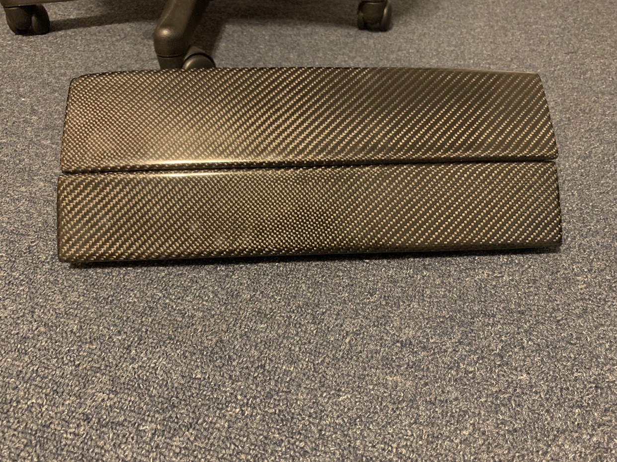

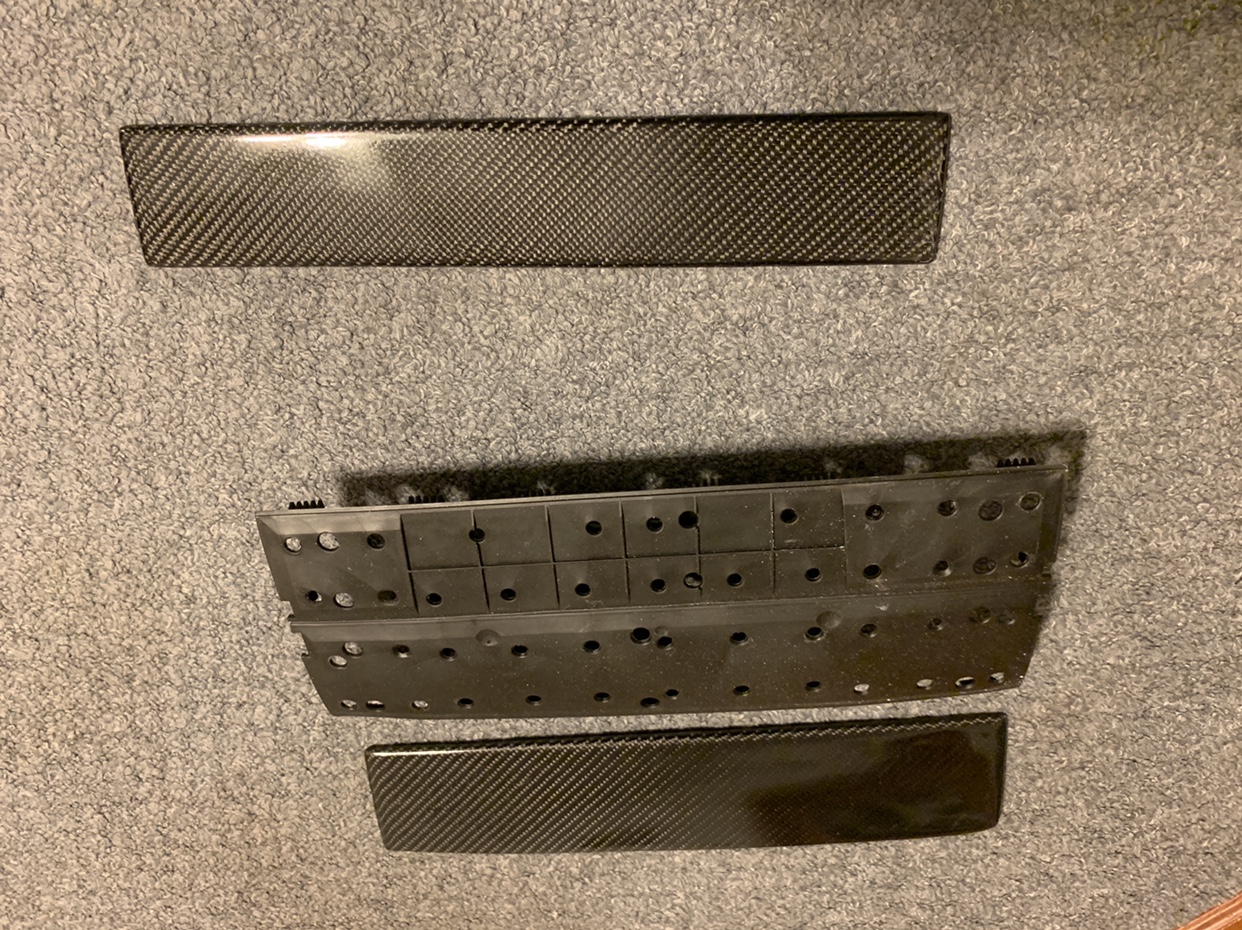

Let's put this to rest shall we? Look at the all rubber piece. This encloses the airbag
Now look at the airbag enclosure with the covers
Would you look at that. It doesn't effect the split. Guess what happens to the covers when the airbag causes the enclosure to split? The covers flap open allowing the airbag to come out. THIS IS THE EXACT SAME WAY THE OEM COVERS WORK
