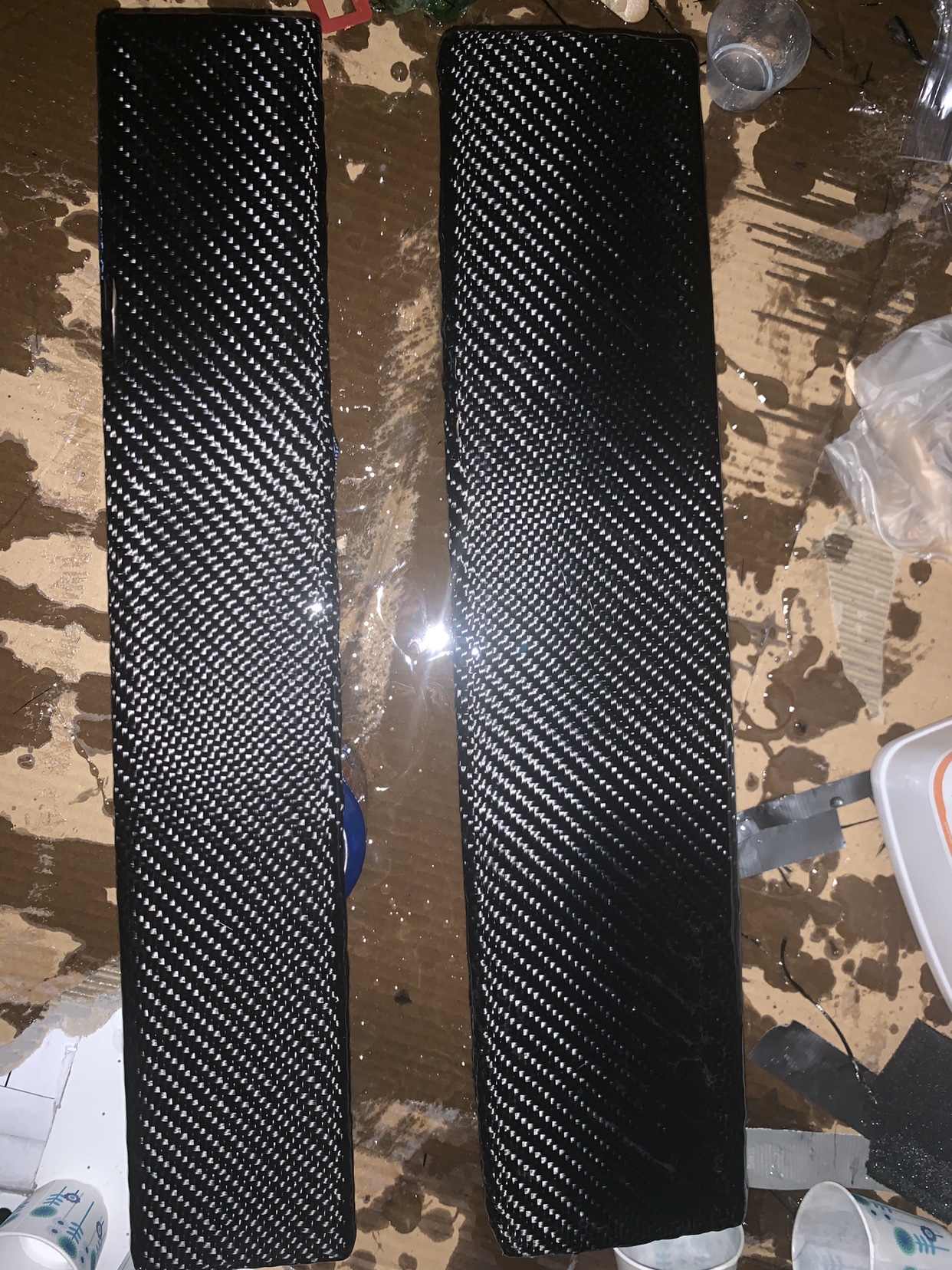

Hey all I've recently been skinning some passenger airbag covers with carbon fiber as sort of a project since no one makes or even sells them for what I can see. I have the full carbon fiber interior but that only includes the cluster bezel, the center and passenger side vent. I was wondering, if I made a few of these would anyone be interested in them? (These will only work on an IUP dash) I am still in the early stages of development with these. There are two weaves. Plain and 2x2 twill weave. Plain weave will match the carbign craft and apr kits while 2x2 will match the carbon overlay kits. I tried many overlays and the fitment was just piss poor. I will not make these out of purely carbon fiber but only skin them as in fact they are the airbag cover and if it deploys it will still have the aluminum and plastic/rubber backing so it doesn't fly apart and shatter everywhere.
AS STATED BEFORE. THIS WILL NOT IMPEDE AIRBAG DEPLOYMENT. THEY REPLACE YOUR EXISTING AIRBAG COVER PANELS. YOU WILL NEED TO REMOVE YOUR PANELS TO INSTALL THESE. THEY ARE HELD ON WITH PLASTIC AND METAL RETAINERS. THE FACTORY TEAR SEAM AND AIRBAG HOLDER IS UNTOUCHED.

These play no part in the mount that holds the airbag. The factory tear seams are not touched. The airbag cover pieces are held on with plastic and metal retainers on the rubber backing with the tear seam...to explain this a little better...the non iup dash airbag cover is one solid piece with the tear seam built INTO the cover because theres no cover there as its just one solid piece. The IUP dash has the "holder" or whatever you want to call it for the airbag that has the tear seam built into it and the stock oem aluminum covers flap out and let the airbag out. The covers have no effect in airbag deployment. This is purely cosmetic. This would be similar to putting a overlay on your dash but instead of it being a sticker, the carbon fiber wraps all the way around the panels. I havent seen anyone do it other than me, but the aluminum covers on the airbag do in fact come off.

I've seen people vinyl wrap the airbag cover and they wrap both pieces together as one. I understand it's vinyl but that will delay the airbag from deploying even more. It would definitely be an issue if I were to make them as one solid piece which I will never do. Plus, I just don't think it would look right without the split there anyhow. I won't even bother if someone asks me to make a solid cover. It will not ever happen even if the buyer understands the risk. If you want a solid piece that bad, they can make it themselves

I literally said it does NOT affect the way the airbag deploys. There are TWO panels in that picture. The IUP dash airbag cover has TWO panels. I skinned them separately meaning the airbag can STILL DEPLOY. I SKINNED them. Basically like vinyl wrapping but with real carbon fiber.
You really wasted your time preaching. Should have read a little more on this whole thread. You talk of hydro dipping them..that's putting a skin over the cover basically the same thing I'm doing but with carbon fiber.
Also THESE DO NOT GO OVER THE AIRBAG. THESE REPLACE THE EXISTING AIRBAG COVERS. Please read before you post. Thank you.
