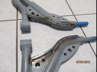

This is what I did after seeing Steve's post. So far these have held up to 3 Auto Cross events and the Optima Ultimate Street Car Challenge and have exceeded 1.3G loads. I will be giving them a full evaluation this season and check them after each event.

jauguarking,
I installed the balljoints myself into the A-Arms and I can tell you they are much stronger pieces than the stock ball joints. Also, I will bet they would never come out of the A-arm either since it maxed my 20 ton press when I installed them. I actually had to ream the hole slightly to get them to press in and had the ball joints near freezing temps to help shrink them.
Breaking parts is part of racing. If you aren't breaking something you aren't driving hard enough. Anytime you try to improve parts and make them lighter then you increase the risk of breakage. I like to always be able to finish races or events so I mod parts and test them as much as possible before major events. We always hope for the best and plan for the worst. This is why safety equipment is important and why I double and triple check everything before races especially on mods to critical components. I try to provide the community my results since many on here do the same and I benefit and well as everyone else does to help further the sport.

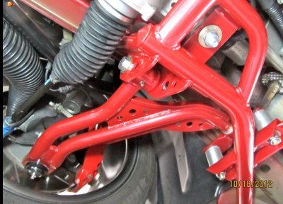

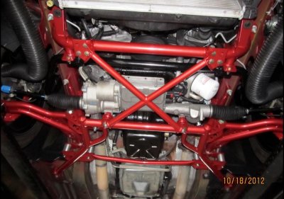

Poe,
That is good idea and wish I had thought to do it with mine just to be extra safe. Since I installed them though I am very confident they aren't coming out though as tight as they were. It is my own butt I have to protect so I do everything I can to be as safe as possible. Since I was modifying the arm already it would have been simple to tack them before the paint though. Will do it on the next ones I make.
Here is a shot of it on the car finished.
