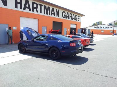

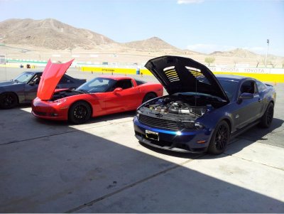

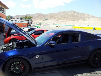

Took the Stang out to Willow Springs and got 28 laps in and here is my track review on the Cortex Torque Arm, Watts Link, Adjustable Lower Control Arms package and other things.
5 others and I rented the entire track at Willow Springs. In other words I had the track almost all to myself on a 79 degree afternoon. I shared it with 5 other cars. How Bitchin that was, I cannot tell you, except I'm gonna try. First let me qualify my words with the fact that I am an Amateur driver with a capital A. Thus, nothing I say is definitive on anything except I guarantee you it is honest.
1st, Cortex stuff. Great as always. Much more grip and really have to push the car in the corners to get the Torsen to engage where you can feel it. But engage it does. Gives me a lot more confidence at the track because what is being communicated through the steering wheel and what is being communicated through the seat of my pants are in harmony. However, I still do not have the cojones to take turn 8 at 120. It is a mental thing because the car is holding the road very well. The biggest difference I noticed between my last track day and today is that in 28 laps I must have shifted at 7400-7700 rpm some 100 times. I did not miss one shift. Same thing with downshifting. My feeling is that the torque arm has stabilized the drive train and eliminated much deflection. Last time out I could not get the car into the appropriate gear on at least 3-4 occasions. This time the "Crummy" Mt82 performed flawlessly. Maybe the problem is not the tranny but the design of our shifter? In any event the torque arm has eliminated the shifting problem completely. Next up Cortex Coilovers? I hear they have a nice street track setup that has a wide range adjustability and I can custom match the appropriate springs to custom valved shocks. Must make more money! Although I am very happy with the Boss Springs and Koni Yellows, and they outperform me by a long ways . . . the track bug is biting me and what the heck . . . I went this far.
2nd, Downloaded Racechrono App to use to lap time at Willow Springs. Sorry to say I could not get it to work at all. Was having trouble downloading the track and communicating with the satellite etc. . . Bottom line it did not work and I did not want to spend my entire day at the track trying to get it to work. I am looking for some lap timing software where I can record videos of my lap and have speed, lap and time info displayed in the playback. Open to suggestions.
3rd, Hawk HP Plus Pads squeal like a stuck pig but work very well and chewed up my rotors. Since I anticipated that, I removed my lightweight Full Tilt Boogie two piece rotors and went back to my stout stock Brembo rotors. Last track day, brakes were melting. this time brakes were stout and very little fade. No smoke. No melt. Did 7 laps straight and by lap 5 I could smell them but no effect on performance.
4th, Set camber at 2.5 degrees. I thought I went as much as 3 degrees last time out but I was mistaken. 2.5 is pretty much the max with the MM Caster Camber Plates. Set Koni's at full stiff after first three laps. Willow Springs is so fast that you gotta go full hard. Started out with the fronts half way and rear end soft. No go. I was uncomfortable. Went full hard and I was very comfortable.
5th, Just toyed with a Vette that was out there. It was legit because he was equally as crappy a driver as I was. When chasing him I was making up approx. 3-4 seconds a lap. When he was chasing me he just gave up after about a half a lap. Theoretically I know my car is better but it is still hard to wrap my mind around it given how much lower and more aerodynamic his car is. Vettes are great track cars and to beat them easily is further proof that these cars can be special.
6th, I make all the mistakes of a weekend warrior. I turn in too early, I don't use the whole track, I miss the occasional apex, I am brave on slow turns and puss out on the fast turns. Despite all that, I had a hell of a time. I improved my driving and when I go back I am not braking for turn 8 and whatever happens . . . . happens.
Temp was perfect. Day was great, car held up great and if there is anybody else in Southern Cal that would like to rent Willow Springs with our group please PM me and we will get you in on it. It is not like we don't have room. Only requirement is don't be a douchebag.
