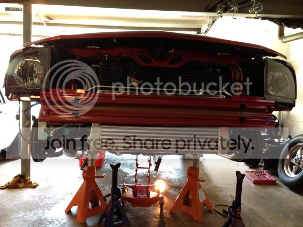

Front mount install:

Transmission is on, driveshaft is on, FMIC install is finished, just need to re-hang the exhaust, route some new trans cooler lines, fill up the trans, and start tuning.

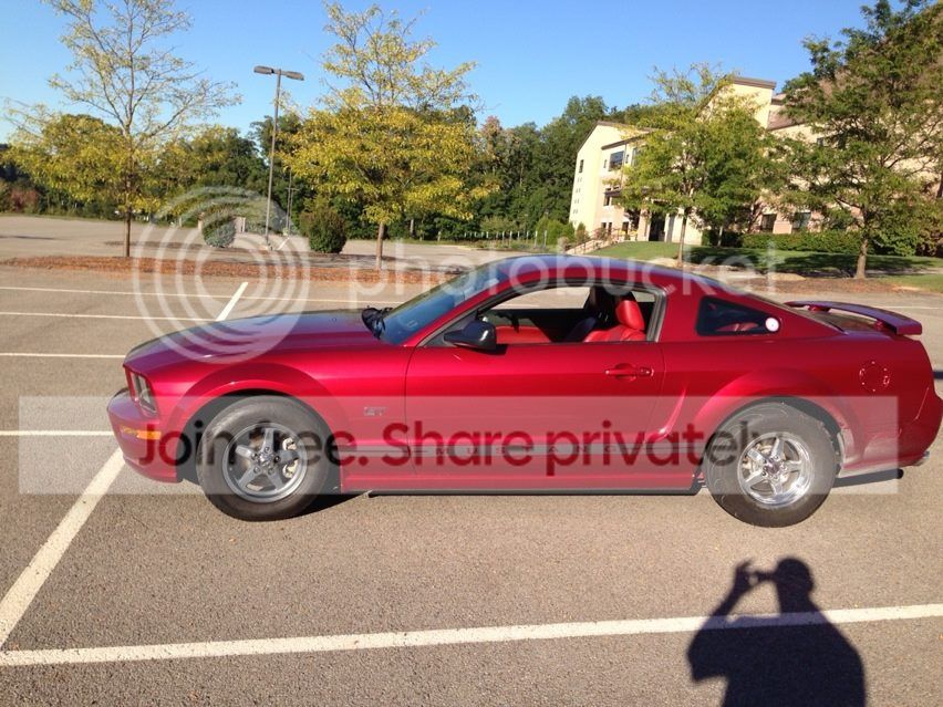

Back on the road....I know it's a terrible pic and the car is filthy. Don't care, just glad to be driving it again. :D
