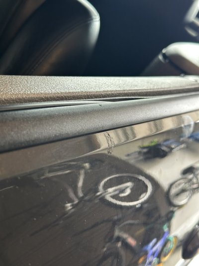

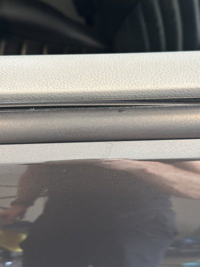

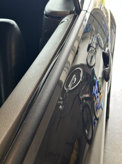

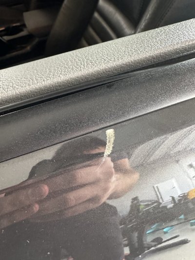

Well, had a big oof moment when I was busy logging and my laptop fell of the car and gouged the paint.
After a few seething hours, decided to say F it and give it a shot at touch up and here are the steps and results:
1. Cleaned the gouge with rubbing alcohol
2. Applied touch up base, let cure for 24 hrs
3. Applied clear, let cure for 24 hrs
4. Applied second coat of clear, let cure for 24 hrs.
5. Wet sanded with 1,500 grit until leveled with existing paint
6. Wet sanded with 2,000 grit until desired level
7. Compounded and polished
Gouge
After initial touch up
After first round of sanding, polishing
End result
Not perfect, but good enough to where I don’t stair at it and get pissed every time I drive the car.

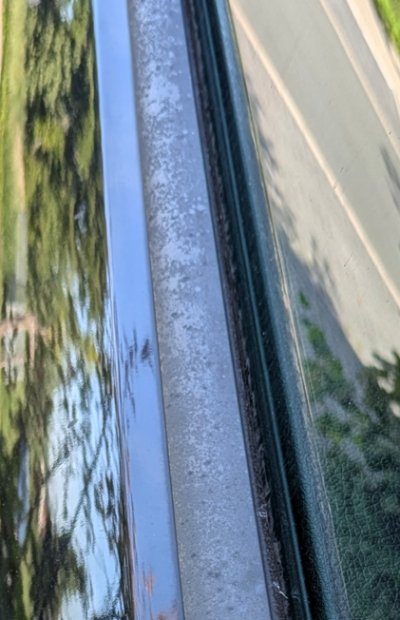

While we are in that region. My weatherstrip is totally faded. What are you guys doing there? I used several trim restorers with not much success. At the door it is like hard rubber and at the roof it is hard plastic.

It is too dark now, will do it tomorrow.

..Armor All . Give those trim a A A. massage every day ... for one week or so. They will look much much better.. and the flexibility is much better also. Great stuff..
