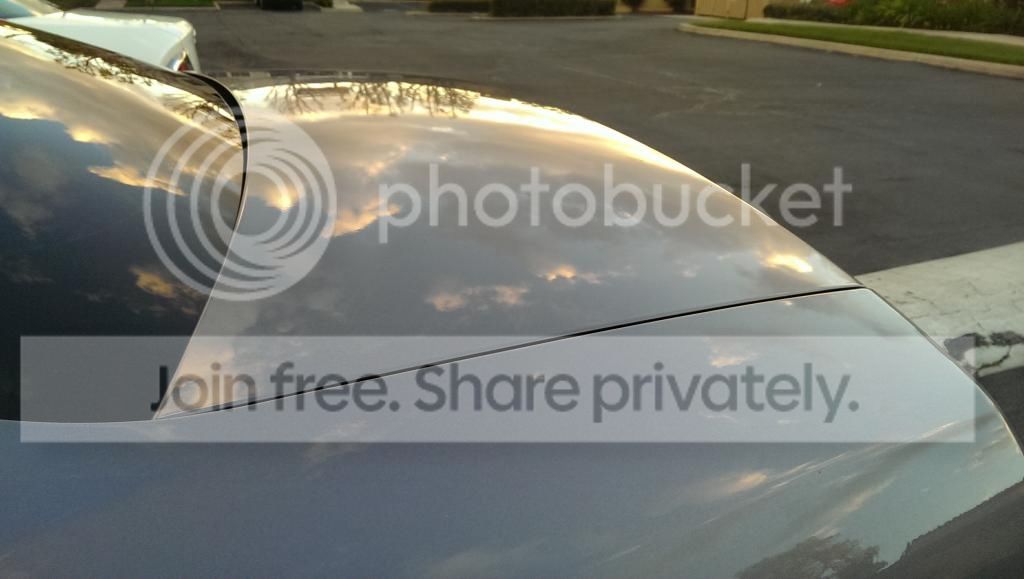

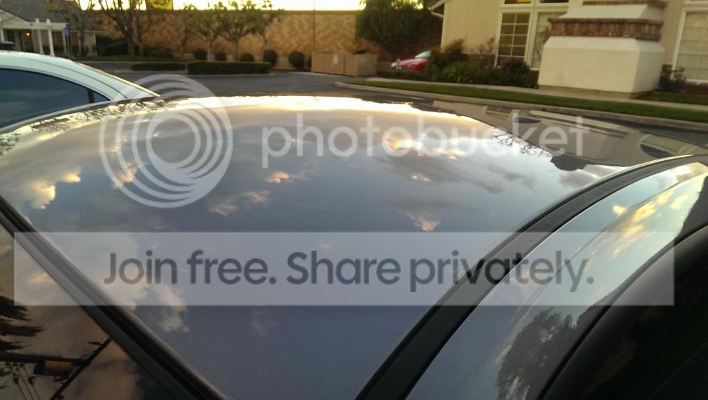

I broke out my Porter Cable and my blue hydrotech pads using Meguars 105 on the hood, roof, rear deck, and other scratch prone areas such as the rear bumper and doors near the handles. If I had more time I'd have done the whole car with 105. My next step was Meguiars 205 with orange hydrotech pads over the entire car. After this, I switched to the crimson pads and burnished the paint with Menzerna SF 4500.

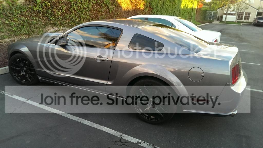

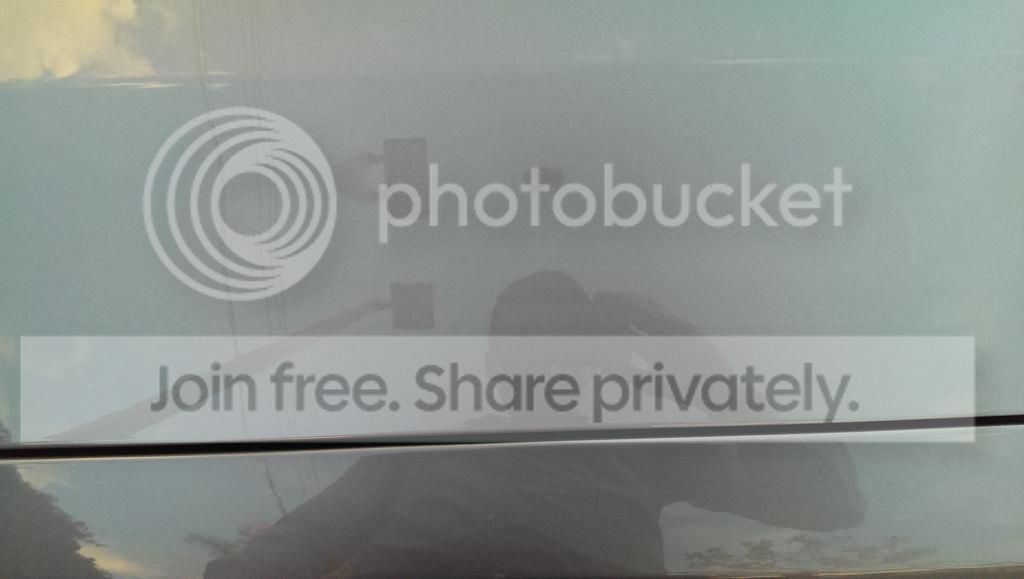

I let the coating cure for about 24 hours and used a light coat of BSD on the car before heading into work. The paint was great looking before, but I feel the BSD added a little bit of pop to the metal flake and left the surface feeling smoother.
Fast forward to lunch and it was raining...so of course I was a little bummed, but at least this would give me an idea how the coating worked. There was a huge amount of tiny beads on the car when it was stationary and these immediately began flying off the car on the short drive home. I used my blower when in the garage and it easily sheeted all the water off my car in about 15 minutes. On the rocker panels, where I normally would have expected dirt from the tires slinging dirt off the wet road, there was nothing at all.
Pics will follow when I'm off...these will be of the car cleaned only unless it happens to rain again before I get off. Just wanted to share my experience and application methods for those of you on the fence!

Looks awesome man, paint looks deeeep. Hard work payed off.
