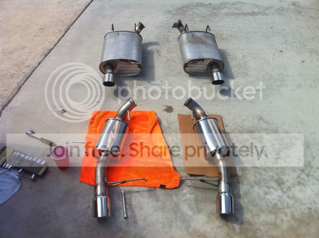

Well, first I laid out what I had just to see them and whatnot.

Passanger side was a breeze. So much that I forgot to take pics. haha. Here they are for size comparison.

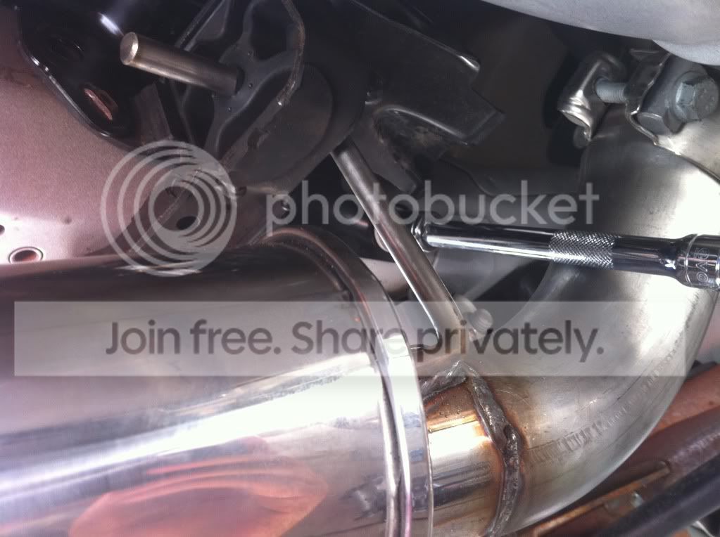

After that, they just bolt back in as normal. Yes, there are only 2 hangers for these, but that's normal. These weight like 28lbs together. What a weight reduction. Anyway, here you can see why I used an extension.
