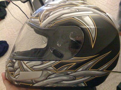

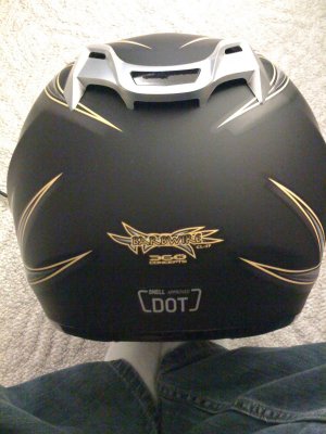

I got a hell of a deal on my new helmet. Normally $185 and got it new for $120 shipped. Here is a pic.

I was going to get one sooner or later. What helmet do I need for a car with a bar? I'm not sure the M helmets will pass.

Shouldn't matter what kind of helmet it is as long as it meets the safety standards of snell 2005 and DOT. Hell, half the guys run open face at our track or MX helmets..lol

I have a G-Force SA2005 rated helmet. I could be wrong but "M" helmets are motorcycle helmets, right? Here's some info:
Key differences between M and SA Rated Helmets (from Snell website):
SA standard requires flammability test while the M standard does not.
SA standard has rollbar impact test while M standard does not.
SA standard allows narrower visual field than M standard (Some SA helmets aren't street legal).
