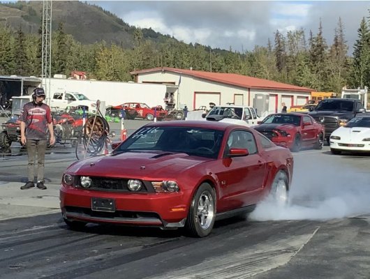

Yes. For my Midlife Crises. This is my little red sports car.

Very nice MC; I got some bad news yesterday. I broke a tooth and went to dentist. I will be working the next six weeks just to pay dental bills. I work six weeks to pay car insurance for a year. over 3 weeks for property taxes. That's a third of a year. Then food, and gas. Not a lot left for toys.
