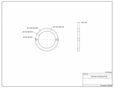

The slave should be pre-loaded correctly.
-Measure from the block/trans mounting surface to the tips of the "finger springs" on the pressure plate.
-Measure from the mounting surface on the bell housing to the "face" of the slave.
-You're going to need to account for the thickness of the "bell housing spacer/plate" into one of the above measurements. Or just put in on the block and do the first measurement with it already on there.
-Take your two measurements and see how much pre-load is being placed on the slave when the trans is bolted up. You want about one inch.
-Shim for goal
Depending on a lot of things I have run shims anywhere from 1/8-1/2" to get things right.
here's my spacer drawing (mine was 3/8):
