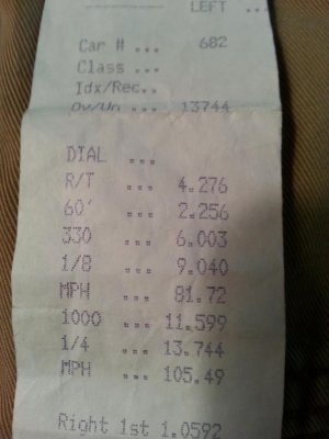

The first pass of the night is the pic posted. The other three runs were mid 1.9x 60' with 1/8 times around the 8.70s at 81-82 and 1/4 times in the high .30's at 106. All runs were on an upprepped track and the da was around 3800ft.
The car is a 2010gt with an o/r x, jlt cai tune, some way too stiff springs and bald pirelli p zero's.

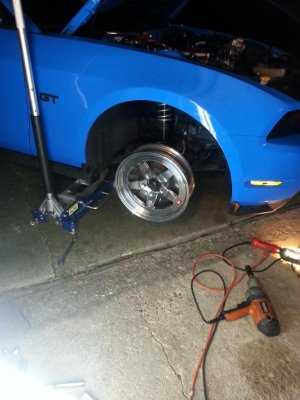

Here it is on the M/T's.
I ran across a set of skinnies for the front, but still am waiting for rubber.
Then if the car will not stop dead hooking, I will have to throw this guy on the stock motor to get the job done. :naughty1:
