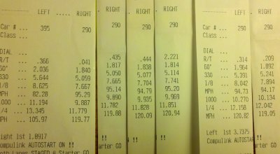

Well guys I went to Capitol for T&T and met up with James(jeostang). My main issues is not getting enough of a burn out to heat the tires properly. You will see this in the video. I did however manage to get a little better than previous 60' which helped me to go from a 11.9 to a 11.779. I also had my fastest pass up from a 120.4 to a 120.94. Looking to get some better times next weekend at JPC's track rental. Enjoy!
