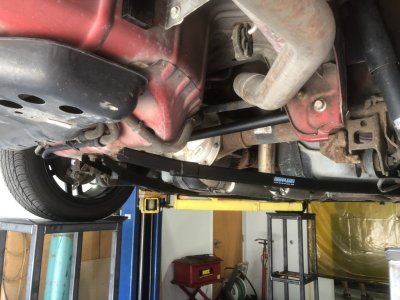

I mentioned earlier that I didn't want my convertible to handle like a "total pig". Since I didn't have a roof (and all the research said because of "that" the convertibles were "stiffness compromised") I decided to take action before I even considered buying a suspension kit (no rear sway bar on my V6). After a lot of looking and phone calls to several vendors I took the car to Stifflers (Innovative Performance Technologies) just south of Indianapolis and had the Stiffler FIT frame stiffening system welded in along with their redesigned S197 convertible rear braces. I also had them install the Stiffler Adjustable Panhard bar and the Stiffler front K-member brace.
If the tune provided a noticeably improved throttle response, the Stiffler FIT system and redesigned convertible braces was a game changer. The car was instantly a better handling car - dramatically more predictable & just plain fun to drive. (Brian Stiffler has Indy car experience and answered my call/questions personally - I have no affiliation w/him or Stifflers).
The point here isn't that you should install the 2015 GT tires/wheel combo take-offs ($450 eBay), Shelby GT 14" rear brakes, 2015 FoMoCo 4 piston front calipers w/14" rotors, 1.25" Vogtland lowering springs, J&M caster/camber plates, tall ball joints, bump steer kit, and align it yourself like I did ... The point is: decide where you want to go ... how much you want to spend and research whether you can realistically get there without breaking the bank (or your will to live).

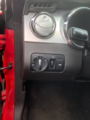

Stiffler Vert Brace1.jpg PS - I made this 2007 Mustang "My Own" by adding a trunk release button - What the hell was Ford thinking? $15 for a used 2010(?) Taurus switch, $3 worth epoxy, console power cut-off switch, sandpaper/file and 4hours of fitment! I must be getting old - no remote trunk switch is just not tolerable!
