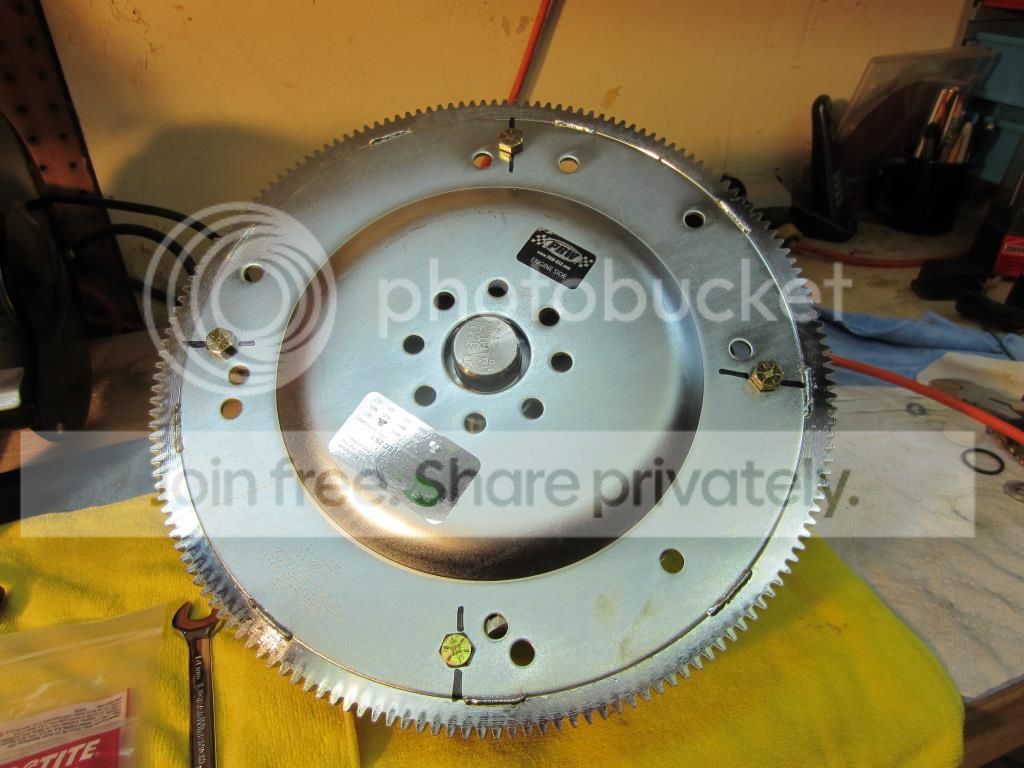

In shopping for the parts I need to get my rotating assembly balanced I need to get an 8 bolt flexplate for my stroker crank. There's a HUGE range of prices for the flexplates. I know you usually get what you pay for but I'm talking from about $70 - $600 range for what far as I can tell is the pretty much the same darn thing! They're all steel, SFI 29.1, 8 bolt, 164 tooth, 1 piece seal, for internal balanced 4.6. Is there any reason why the expensive ones are so much more expensive?

I'm probably just going to order one of the cheaper flexplates unless I can find a good reason why to pay the difference for the more expensive units. Which so far, I haven't been able to find anything and nobody has offered any reasons so..

PRW it is! Thanks.
