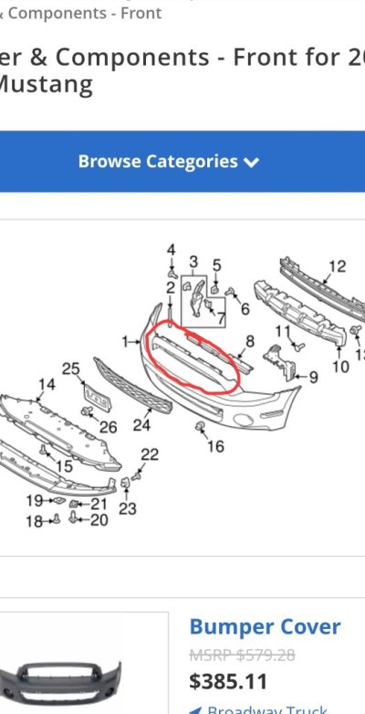

Does anyone have part numbers for the four silver colored bolts/screws and the black plastic push pins with the Philips heads center insert that hold on the upper part of the bumper cover on a 13/14 base model?
The bolts screws I'm referring to are a coarse thread plastic cutting screw that goes into the upper core support it retains the actual body colored piece of the front bumper cover at the top underneath the radiator cover, close out (piece with the decal).
I can't seem to determine what they are, as they don't show up in any of the exploded parts views.
Any help you can provide would be greatly appreciated.

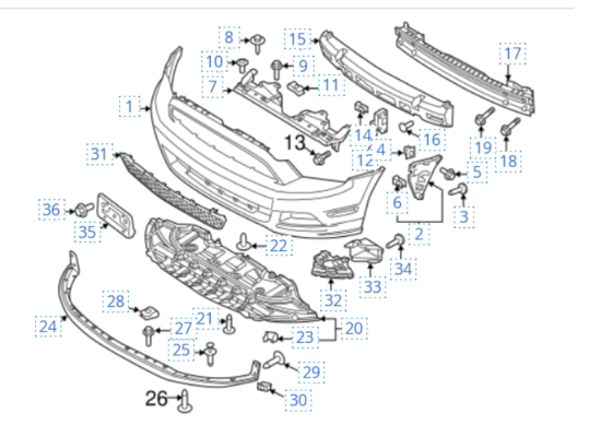

Hey FireFighter46/Alan,
Looks like items 8, 9, 10 (and, maybe, 13) are the hardware parts needed. The snip is from "Tousley Ford" [old name] which is currently Apple Ford, located in White Bear Lake. The Parts gang at Tousley/Apple Ford have always been very good to internet customers. I don't have any relationship with the company other than being a customer.
HTH,
Chris
