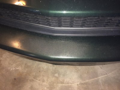

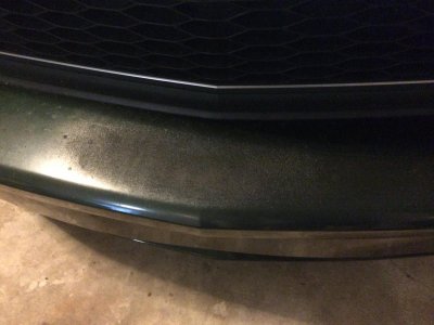

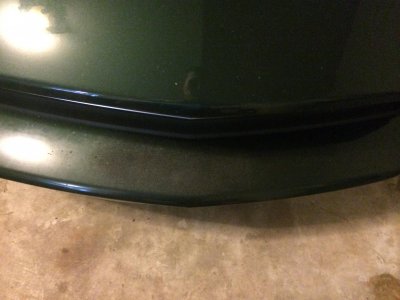

Hey guys,
I've got some pretty bad damage to my front bumper and I was curious if there's any way to repair this. The car spent all of its life in the South Louisiana/Texas sun. I'm not sure what caused the damage though. If you can't tell by the photo, the damage is definitely rough to the touch.
Anyone seen anything like this? Any thoughts?

Sand and repaint I'm afraid. My guess is the clear coat has deteriorated. You might try like some 2000 grit wet sand, rubbing comp then polishing comp and a cleaner wax to see if it improves any. If not, time for a respray of the bumper.

Hard to say but my guess is your clearcoat is failing. If that's the case, gonna need a repaint man

It looks kind of like severe oxidation and that is possible to correct with the right experience and technique but more then likely you ll need a repaint.

I'm guessing clearcoat failure. Looks like a respray is in your future.

Like the others have said, it looks to me like clearcoat failing. Resembles what I saw on my old black car. Repaint is probably all that can be done.

It looks like oxidation, if you're lucky you can compound it out then polish. The positive part of that is that it's worth trying because if you mess it up, you're no worse off and still looking at a repaint.
