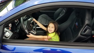

HOLY SMOKES those are AMAZING seats!
Where did you get them from?
