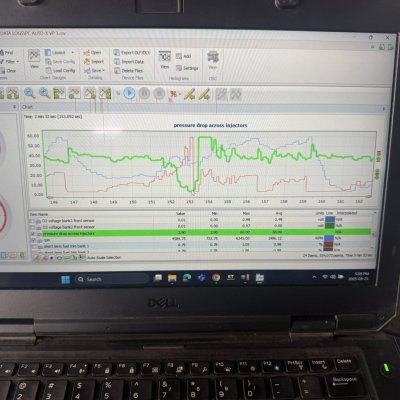

Here’s my issue, during an auto x event I was experiencing a cut/hesitation in acceleration. Rounding a corner applying throttle to power out've the turn then all engine power goes out then springs back to life. Grabbed my laptop and recorded a log. Come to find my fuel pressure dropped to 2 psi in that moment (bad) sent it to Lito for overview and he thinks my pump may be caveatting or sucking air as all other data supports the pump being okay. Essentially cars acting like I’m running outve fuel.
Fuel filter only a year old. New pump strainer. No visible leaks, no codes runs and drives fine under normal conditions. Only when working the car hard. 3/4 tank at time of issue and cross over is connected I triple checked it.
This happened day 2 of racing and day 1 there was no issue present. I highly doubt its fuel sloshing around as I’ve never had that before hand and I had more than enough fuel.
Anyone have ideas on what’s going on here? Going to dig into it this weekend. Attatching picture of log. (FP GREEN) (RPM BLUE) (TPS RED)

Looks like cavitation to me. There is an old TSB out there so it’s a known issue if you are still running the original pump

Thank you, I’m running the stock hat but swapped out the pump for a higher capacity one. So I wouldn’t think it would cause that but maybe the pump is. I’m leaning towards fuel starvation even though I had 3/4 fuel and I’ve gone below half so it has to be transferring fuel but it could’ve just been angry for some reason. I haven’t found anything yet that supports either
