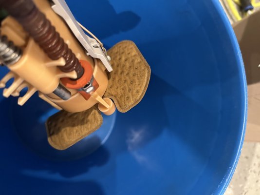

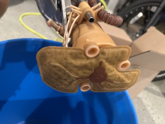

Went ahead and pulled the pump.
Figured since it was about 20 years old, I’d just replace it so I got a new MC pump. Pics of the old pump sock attached.
After some testing, looks like .2 FPDC at idle, and maxed out at .42 FPDC now at 6800 RPM at WOT.
Will have to see if it keeps the P0300 and P0316 away.
