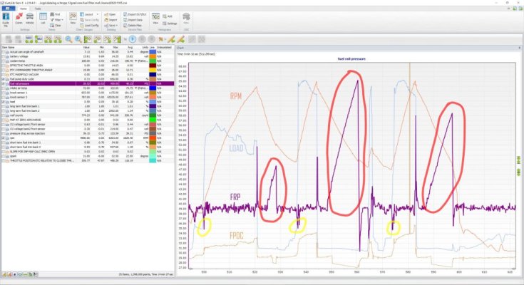

My log shows strange spikes in the fuel rail pressure and I can't make sense of it - I hope you guys can?
My 2008 GT Automatic had issues with loud pinging/detonation on hot days.
I flashed the stock software back on and ran some logs to see what was going on (engine is otherwise stock).
LTFTs were high under load and fuel pump duty cycle went up to .48 (96%), so obviously a fuel delivery problem.
I changed the fuel filter, cleaned the MAF and reset the KAM. Now LTFTs look fine (0-3%) but fuel pump booty cycle is still high at .44 (88%) WOT and .26 (52%) idle.
I ordered a new sock filter/restrainer for the pump - but there is something else going on that I don't understand:
My fuel rail pressure increases dramatically for up to 10 seconds whenever I let off from high RPM (marked red). WHY?
Another issue is that whenever load is applied, the fuel rail pressure drops for a second (marked yellow). I guess that could be fuel restriction and will hopefully disappear once the sock filter is changed?
Anyone having an explanation for the spikes?

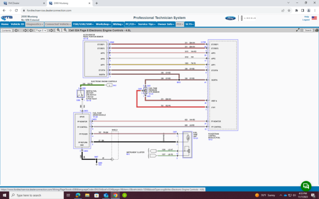

Yes, the fuel system is stock. What makes you think it's the Driver Module and are there ways to check it (apart from replacing it)?

Check voltage on the wire coming off the module to the pump itself as shown on schematic. I don't know if that is the specific concern. I know that it is in line to the pump.

None of that is unusual. The long spikes up happen when you go into decel fuel shutoff. The engine stops using fuel, but it's returnless so the pressure builds up since the pump is still going. Note how the FPDC keeps going down to try and compensate. The downward spikes are also normal. Remember that this is differential pressure of the fuel rail vs the manifold pressure. So off throttle you might be at 35psi fuel and -5psi manifold (made up numbers as an example) to be at a target 40psi. When you hit the throttle manifold vac drops, so you might instantly go to 35psi fuel and 0psi manifold which would show as a drop in differential fuel pressure. Also, the sudden change in fuel demand means the pump has to ramp up (notice the pump DC going up) and it takes some time to catch up. The opposite is the reason for the short spikes up when you get off throttle. Nothing to worry about.

"None of that is unusual." - Wow, that would be great! I hope at least one other person can confirm that.
What I still find puzzling, maybe you could elaborate: If the fuel pressure after let off has nowhere to go (only through the injectors which are closed) - how can the short spike in pressure be instantly released, but not the long one? How can the long pressure spike suddenly disappear while load remains zero with injectors still closed?

With the dirty sock filter, and foot into it, rail pressure dropped like a rock. Back off the gas, and rail pressure goes back up.
I removed my sock filter, cleaned it out, and re-installed it. After that, pressure did not budge.

I can confirm that this is more or less normal w\ this Ford S197 OEM returnless FPDM controlled fuel delivery system as TripleFJeff has described. Usually just after you've fully let off the APP which will tell the ECU to go into full DFSO (the 1 item you don't have selected in your graphs is the APP which is the initiator of all the other graphed items......the item that you--the operator of the engine--is telling the ECU what your wants are). You're dropping from a high load to a no load situation in a very short period of time.......like during a gear shift, the ECU command to the FPDM to shut the FP down then the FPDM's reaction time to carry out this command just isn't fast enough to prevent this from happening a majority of the time.
As for the long spiked fuel pressure off DFSO dropping off while still in DFSO, how many folks still have the pprv (positive press relief valve) installed in the fuel pump hi press side-to fuel pump low press side & if they do (std in OEM Ford fuel returnless type systems), do they still not leak by (I know mine does--tested & verified leaking.......the FP assembly is 15 yrs old--the original FP assembly the car had when it rolled off the assembly line--doesn't hurt anything by it leaking by as this part's sole job is to prevent excessive high line press deadhead between the FP & the fuel rails.....like say 100 psi depending on the press the pprv was set to relieve).
When the APP (accelerator pedal position) is still at .000 A\D counts the fuel system will stay in DFSO during decel until the engine RPM's drop below 1,000 RPMs.......or until you press on the APP & it starts to increase A\D counts......this tells the ECU that you--the operator--wants to start applying TQ again thus the ECU will suspend DFSO & reengage the fuel injectors thus momentarily dropping the system fuel press until the FPDM can react to ECU command & spin up the FP again.
The key is to monitor the APP A\D counts output in relation to all the rest of the outputs......then it will all come together.

Thanks a lot! I'm relieved that these spikes are normal. Regarding the high FPDC: I will change the sock filter/strainer on the pump and see if that has a positive effect. If FPDC remains high after that, I'll consider the wire mod, thanks for sharing!
One more question while we're at it: There is "Fuel Rail Pressure" and there is "Pressure Drop Across Injectors". The latter is a delta pressure taking the varying manifold vacuum into account with the system always trying to maintain 39.15 PSI at the injectors, right? So, is the assumption correct that there is enough fuel as long as "Pressure Drop Across Injectors" stays at 39.15 at all time?
In general terms, yes this is how a FPDM controlled returnless fuel system is designed to operate.......but the assumption is not always correct. This is why a WB O2 sensor is generally used to ensure that the fuel delivery is actually there. But if you don't have 1, there is another way to get this info using your SCT LiveLink datalogging software.
I'm sure you already have the MAF airmass channel graphed, so now set up the FP flow rate channel in your graphs & graph this as well. Now if you can set up a math channel to do the math, set it up to divide the MAF airmass output by the FP flow rate (make sure that both outputs are set to use the same unit of measure...say lbs\min.......this makes the equation work properly) as the result will be the actual airmass to fuel ratio--or AFR--the engine is actually using (example: 21.67 lbs\min flowing airmass \ 1.89 lbs\min fuel flow rate = 11.47 AFR). Then compare this result to the ECU's in-tune EQ Ratio Lambda equation's fuel stoich AFR x commanded Lambda (example: 14.13 x .82 Lambda = 11.59 AFR).....now you will definately KNOW if the FP is actually properly delivering the necessary fuel delivery along w\ the proper FRP ref as in this example, the FP is actually delivering slightly MORE fuel than is actually commanded.....but the difference is so small between the 2 (.12 AFR difference) that it ain't worth messing with thus all is good.......you don't need a WB O2 sensor to find this out.
This is another method to ensure that you're actually getting delivered what the ECU is commanding...........
The decel fuel shutoff is on a timer. So the first, short spike is from the transition to off throttle but fuel is still on so it returns to normal quickly. The long spike is the decel fuel shutoff which happens after a certain time at closed throttle as long as the rest of the criteria are met. I don't know about automatics, but on a manual car of that era (RYA1) it's 4 seconds.
