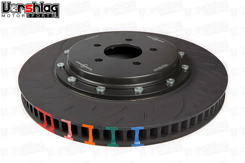

Slotted faced rotors are normally done on REAL RACE BRAKE SYSTEMS to keep the pad surface clean... it scrapes away tiny slivers of brake material, like on this 2-piece Powerbrake branded 380mm S550 rotor above. This DOES accelerate rotor wear, of course.
