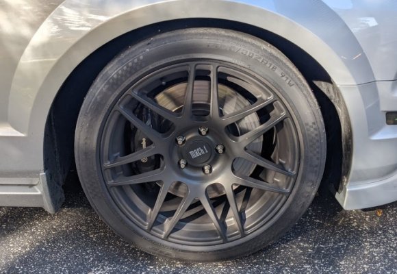

Both of the kits you linked use the same caliper which is a brembo copy. The Brembo 4 piston calipers will bolt on directly and need 14" rotors and new brake hoses. The only difference is one link is calipers only and the other is calipers and rotors. Plus you're paying a lot extra for red. Black and silver are cheaper, unless you really like red. Lastly the Brembo calipers and 14" rotors will fit inside some 18" wheels and all or mostly all 19".
These are 4 piston Brembos, 14" rotors, 18x11 Forgestars and about 3/8" clearance between caliper and wheel.
