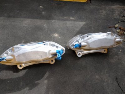

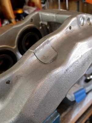

Here's some photos of how I cleaned up and reworked my Fembos. They look sweet, painted high heat black, except for where some brake fluid leaked out of the bleeder threads. I put some yellow teflon tape on same, which you should do ahead of time, solved this issue.IMG_20170419_132922.jpg IMG_20170419_143345.jpg IMG_20170419_143756.jpg IMG_20170419_153542.jpg
