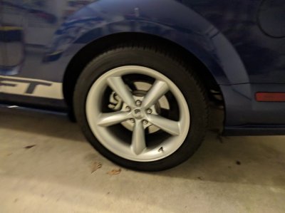

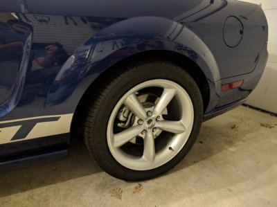

I am a dummy when it comes to tire sizes and what I should run. Car is a street car running 275/40R18 in the rear. I would like the most aggressive/drag tire to fit on the 18" wheel. I know it would be better to run a 15" wheel but I really these wheels. At most, it would see the track rarely. I included pictures of the current wheel gap. I measured approx 2" - 2 1/4" in between the wheel and outer fender. Car is sitting on Saleen Racecraft Shocks and springs.
All suggestions appreciated on size and which tire . Don't mind increasing the overall diameter as long as it fits and I rub like a VW :)

How wide are those wheels ?

18x9 with an offset of 36, should have mentioned that.
I looked at the sticky post and my numbers don't add up.
It seems like I want something like a 275/45R18 to keep the same width and add a little sidewall?

The 275/45 is taller than stock. Good choice if u have 3.73 or steeper rear gear. MT makes the SS tire in that size
