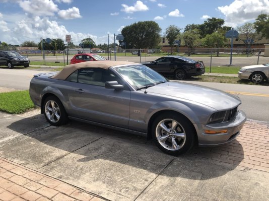

I had original 18" chrome wheels on my old 06' GT convertible. Also, Shelby's, Bullitt's and GT500 all come stock with 18" rims.
