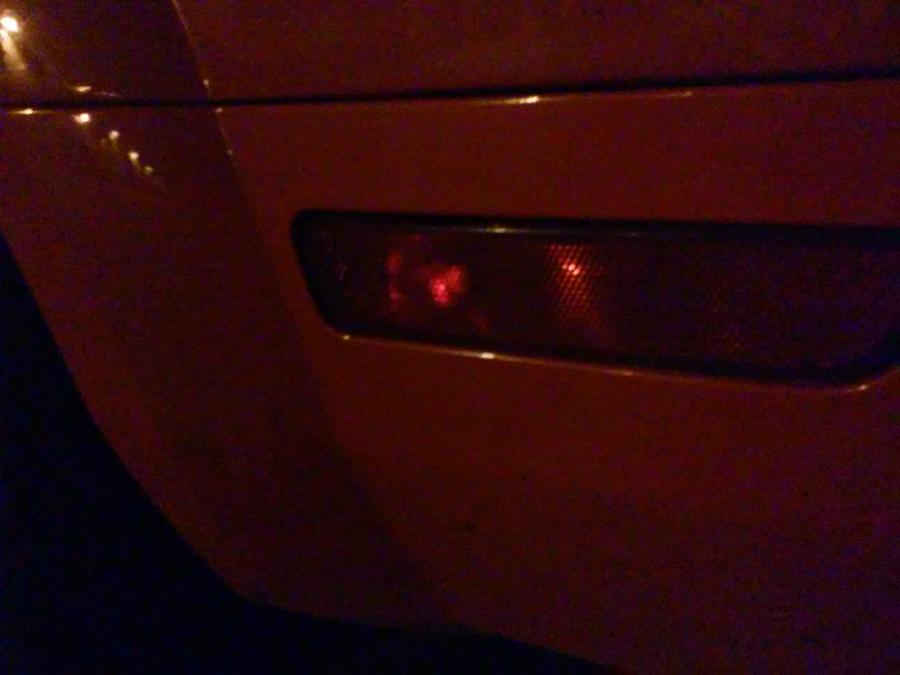

194s in the side markers, front and rear.
3157A (amber) front signals.
3157R (RED) all six rear tails.

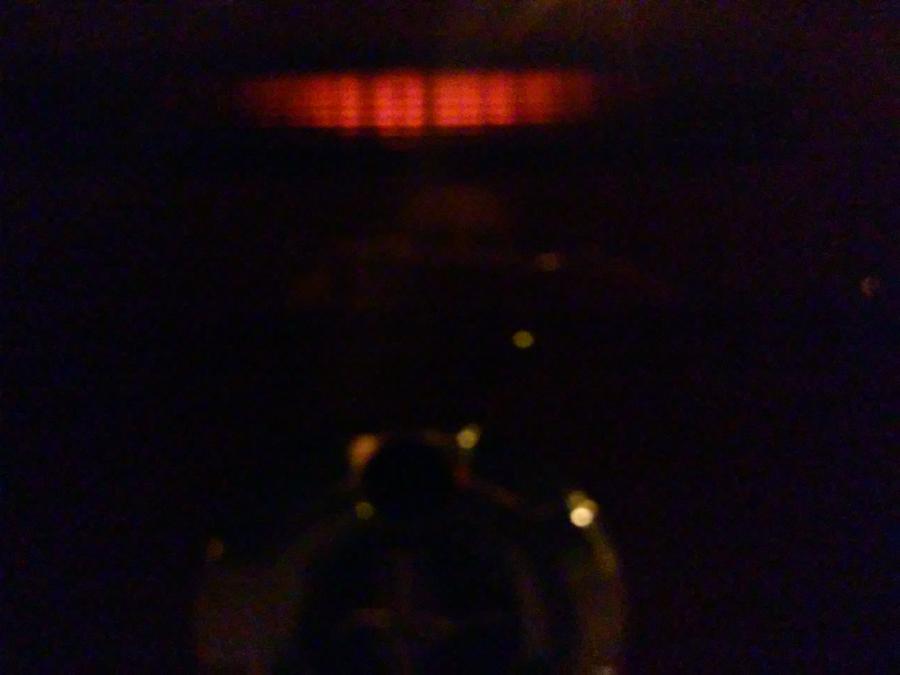

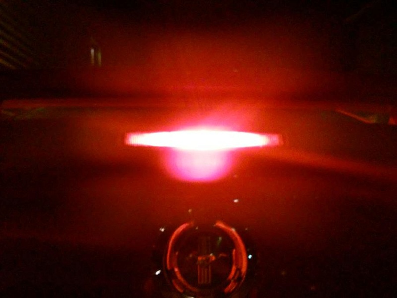

I made my own LED center tail:
When the car is off, for like 8-minutes, whenever the car goes to sleep, they're on REAL
dim, only the rear LEDs, tails too:
Does not drain the battery. I drive the car on weekends only.
I do not have any pictures that clearly show the LEDs in the tails.

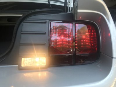

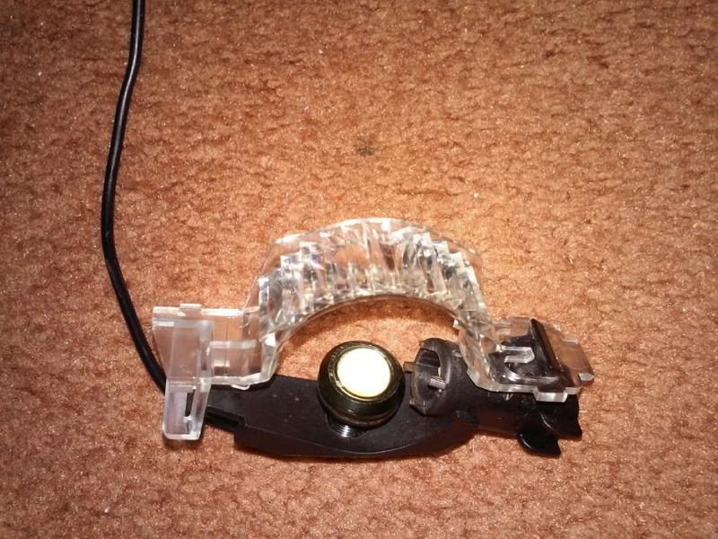

I received the LED bulbs and installed them Saturday. I tested each Sylvania bulb individually before butting up tail lamp assemblies and they worked as expected. Reverse lamps are superbright and well worth the $$. Hope they last.
I took the car out in the evening and at the first use of the turn signal noticed hyper flashing. I got to my destination and checked the tail lamps. Brake and tail lights worked properly. Turn signals would not turn on. They did work when the hazard flasher button was engaged though. I proceeded to turn off the engine and engage turn signals, lo and behold they were working properly. As soon as I turned on the engine, hyper flashing returned and turn signals would not light up.
I have a Saleen so I only replaced 2 led bulbs per side as my most inner sense is covered by plastic baffle. Would having a mix of bulbs (2 LED and 1 incandescent) in the harness affect the overall performance of LED bulbs? If so, I would need to replace remaining incandescent bulbs with LED ones...
LED Sylvania bulbs installed
Incandescent bulbs
LED Reverse lamp
Incandescent reverse lamp
