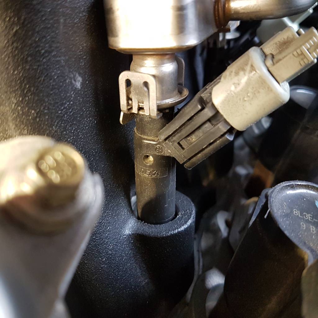

Im trying to find out if these are 60 or 80lb injectors.
The only label i have is E022A00401.
Ive google'd it and come up empty. Anyone recognize them?
Sent from my SM-G930W8 using Tapatalk

If no one can ID based on the photo or # you could take one to a testing company and they could run it on a flow bench. A local place charged me $10 a piece to verify some GT500 injectors I have.

ev1 60mm height sd 80s should have a blue band around the base just above the lower o-ring, while 60s should be all black.
