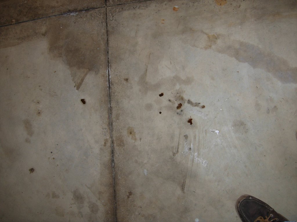

I noticed last year that my 08 GT had leaked oil onto my garage floor. The stains were near the front left corner of the engine.

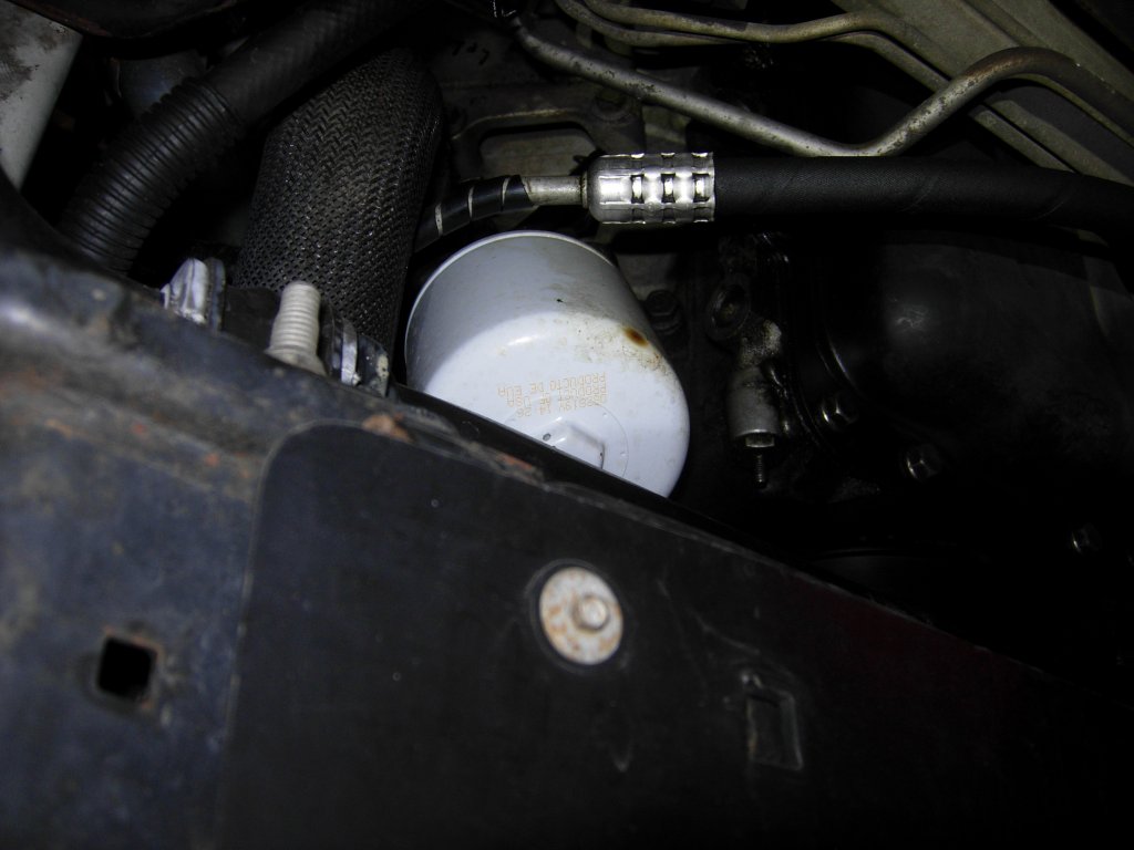

During last fall's oil change I realized that the problem was the oil filter adapter gasket.
You may have an adapter gasket leak if your filter is correctly tight, but you still have oil on the outside.

Thanks for posting this.....I'm seeing the same on my oil filter but I couldn't see\find where the oil was actually coming from (all area visable around the adapter to block mounting area is dry so it must be coming from under 1 of the adapter bottom bolt heads like the video shows). Gonna put this repair on my to do list just before I plan to go for the next oil change.......
