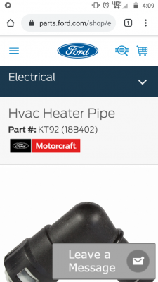

Well there's a pool down there too. Must be splashing up around gasket. Or something. Where can I find the fitting so I can get it before I tear the car apart?

Yes I had the same problem it was the heater hose elbow connector part number 800 419 got it from Napa. All you need to do is take the alternator off cut the metal clamp with a small hack saw . The elbow connector pull while pushing the two white ends it will come loose. Make sure you get all the elbow out of the hose. Put it back together with a clamp put all back together. Ps make sure if you have a 5 speed do not drive your ride like this because it will leak down the bell house and it will be time for a new clutch kit and tob.
