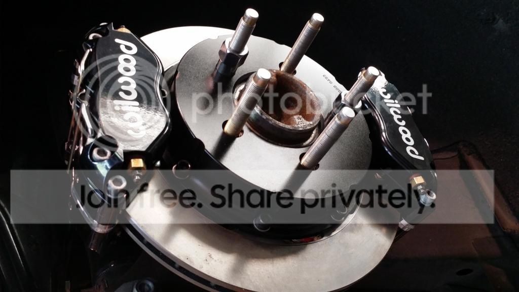

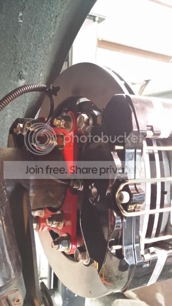

In an effort to make our car more consistent, cut better R/T and to gain in the sixty-foot, we decided to go ahead and make a bolt-on dual rear caliper kit for our car. We are not really decided yet if we are going to make this an available part, or not.
If it does become a part (kit) that we offer, it will come with everything to bolt the pieces on and go. You will retain the ABS, etc etc etc.
We are still buttoning this up, and doing some testing at an NMRA Race in a few weeks.
Just thought I would share. ;)

So what is the bonus of having dual calipers on the rears of a drag car? I could maybe see dual fronts on a corner carver?

On your average persons basic bolt on car, with an auto...it will assist in better reaction times, better sixty foot times, and better consistency.
On a manual trans car, they just look cool. Lol

Turbo guys use them to stage, but lately, a lot of the faster guys are going to pressure bypasses on the transmission. Still a great product with a lot of usefulness, but it's starting to be eclipsed by other technologies.
