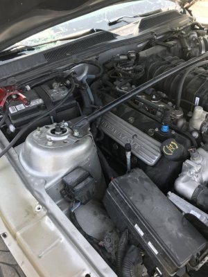

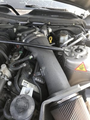

So story is I've come across a stock 2009 GT-500 that was side-swiped on cabling guard-rail by the owner and subsequently picked up by a local wrecking yard. Went out to take a look-see and overall the car isn't in that bad of shape. Right rear quarter panel folded up pretty good. Front bumper broken in half. Left front quarter gone. Rest of the body intact. All wheels/tires in good shape. Appears she got caught in the cabling and spun ripping off panels as she went. Airbag didn't go off however. Engine started up and ran fine; around 30K on the clock. Rear seats are wet (open to the elements; rear glass broken). Rest of the interior is good. (Recommendations for issues/items/areas to take a closer look at should I want to pursue this are welcome). Deal is the yard wants $13K for the entire car (is that reasonable?) and I bring it back after I'm done with it so they can take the brakes and other salvageable parts for other projects. I get whatever I need to do the swap over (engine/trans/rear-end/harnesses/gauges/interior pieces/etc).

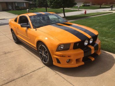

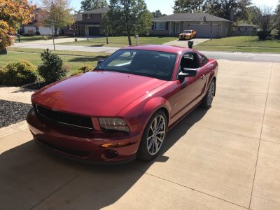

Here's where the fun begins. I have a 2006 GT with a DOB setup and my son has a 2007 stock V6. His car looks fast (Roush body work/stripes/Grabber Orange) but isn't so this may be an opportunity to rectify that. He's in college now so could be a great graduation present...

Anyway, a couple more details on this deal. The car got into a guard-rail (cabling type) so that's what tore up most of the panels. The hood is dented around the drivers vent and scratched but salvageable and could be transferred over easily. The axle-backs are still okay but the passenger side under car exhaust piping was torn up. The stock GT500 wheels are fine and most everything in the interior is still there sans the door panels. Per the deal I buy the car outright and able to take off whatever I want. I actually want to return it to the yard after I'm done so I don't have to deal with junking it (unless I'm worrying too much over a non-issue (opinions?)). I already have Brembos so I don't need them. That was really the only thing the yard wanted from the car. That does however present an issue I hadn't thought about before...if I do the swaps it would probably behoove me to add the anti-lock system to my son's car so that would be something else to plan for.
