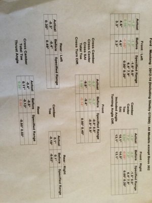

Just to follow up- the dealership was able to get both arms on straight and the vehicle aligned. Drives perfect now. Looking at the alignment sheet it shows the thrust angle and toe were off.
Dude please explain how they adjusted your thrust angle when there is no adjustment for it with out adjustable lower control arms.
Your car is dog tracking but not much. You just don't know
Sent from my iPhone 5 using Tapatalk
DetTigers
Jul 4, 2011
25
As Kelly stated there is some play in the passenger side bracket. I'm assuming when they re-installed the brackets they were able to get them even which straightened out the axel, correcting the thrust angle. I attached the alignment sheet if that helps. If my car was dog tracking wouldn't it be prevalent in the alignment specs?

As he stated, there is a little bit of play within the mounting system on the passenger side bracket. The bracket needs to be installed and torqued in the rear-most position. Sometimes, it takes a little effort, but is doable (I have done it 50+ times)
The play within that mounting is not by accident. These cars are all different, and coming up with a design that works for every single customer is next to impossible. There is not a single design on the market that is perfect, on each and every car that they are installed on.
The OP simply proved the point I am trying to get across. His original install gave him a thrust angle that was slightly out of spec, the Ford Dealership simply loosened the brackets, maneuvered them, re-tightened, and now it is well within spec.:thumb:
