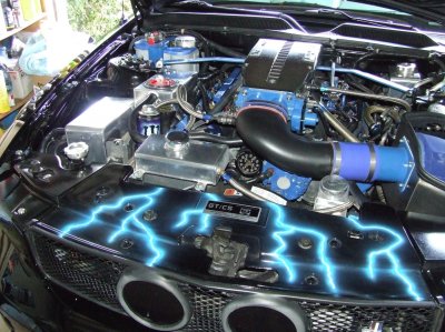

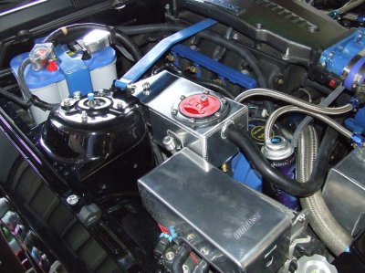

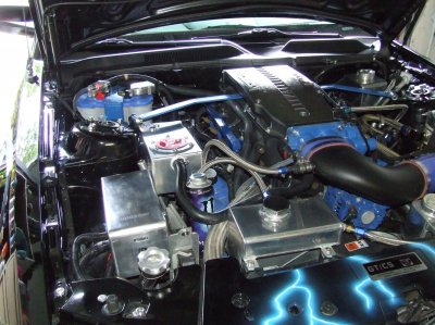

If you can weld you can make one. I used scrap metal and my mig welder and a weekend to make mine.

On Canton's Radiator tank there is an overflow line that is not on the stocker. When I installed it several years ago I looked around my garage and found some SS line and a Monster can. At most Dragstrips or other race tracks you need to capture any possible loose liquids. That was my solution. Also it gets alot of attention at car shows.
