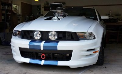

I replace the OEM radiator with a FRPP part, and got the hood on it. I also installed a Blowfish tow hook to help get it onto the trailer.
I tried to add pics, but it keeps telling my I've exceeded my quota.
