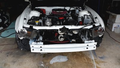

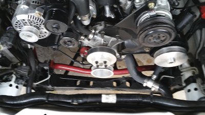

This weekend, I spent some time pulling the front end apart to afford easier access to the front of the engine.
I called Dyers Blowers on Friday, and they said they needed my existing crank pulley and reluctor wheel (using the OEM crank position sensor to drive the factory tach) so they could make a custom blower pulley adapter. This will let me keep my fox body serpentine accessory system.
Things I'm gong to have to give up are the A/C and heater, as well as removing the OEM radiator fan, and replacing it with an aftermarket pusher fan mounted in front of the radiator. Obligatory pics:

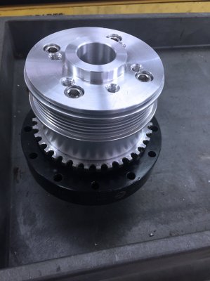

- Dyer's needed my balancer, trigger wheel and crank pulley so they could determine if they needed to make an adapter, or make a whole new pulley because of my serpentine accessory belt. This is a free service if you buy a blower kit (which I did).

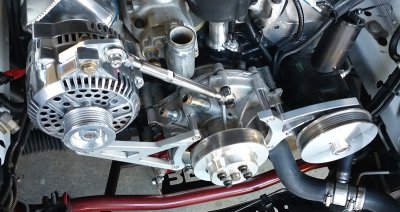

- I got the new March accessory brackets and installed them. The alternator kit required me to cut 1/4-inch off of two of the bolts so they could be threaded in all the way, but other than that, it was pretty easy going. The power steering side was a bit more problematic because I already had a March pulley on the power steering pump, and I couldn't use a standard power steering puller on it. I ended up having to combine three tools in order to get it off. I threaded the PS puller stud into a harmonic balancer puller, and threaded the PS puller nut onto the puller stud on the pulley side of the harmonic balancer puller. The, I put the box end of a 11/16 wrench on the PS puller nut. Finally, I used three long-ish bolts through the harmonic balancer to thread into the PS pulley. Wait a pain in the ass. Mounting the actual bracket and pump, and reinstalling the pulley was trivial (didn't need any weird tool combinations). BTW, I google it, and there doesn't appear to be a puller available just for the March pulley.
- After installing the new PS bracket, the pressure hose from the pump touches the header. Worst case - I may have to have a shorter hose made. Grrrrr...

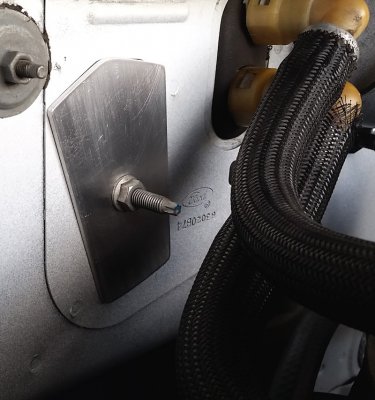

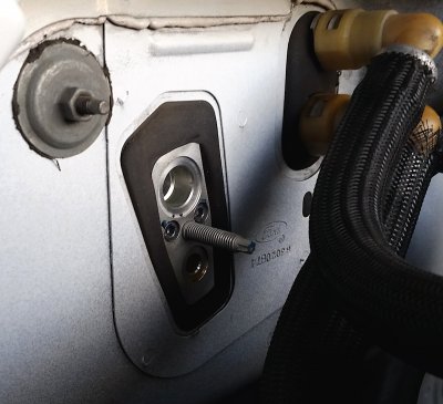

Here are some pics of the blockoff plate I made for the AC hookup area. One pic is what I started with, and the other is the installed plate.

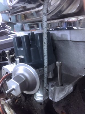

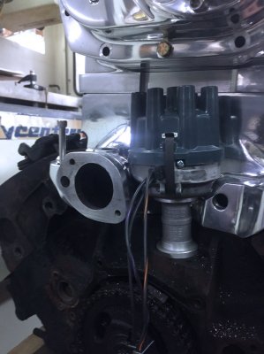

Dyer's sent me a pic of a duraspark distributor being test fit with the intake manifold - that is REALLY tight!

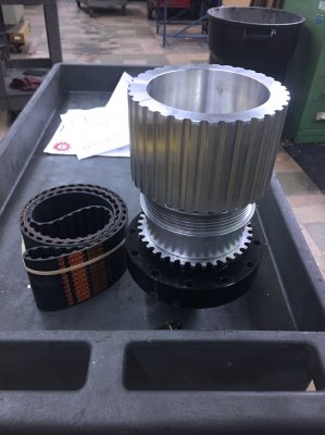

I'm using a serpentine belt system, and they requested that I send them my balancer, trigger wheel and pulley so they could make a custom crank pulley for me for no additional charge over the cost of the kit.

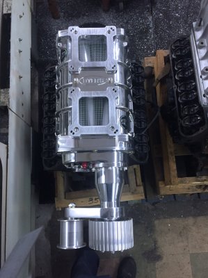

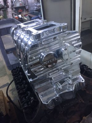

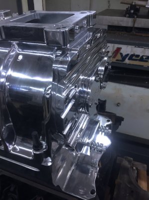

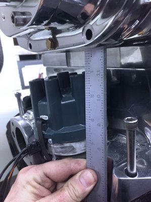

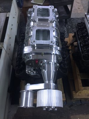

Pre-shipping mock-up pics from Dyer's:
