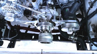

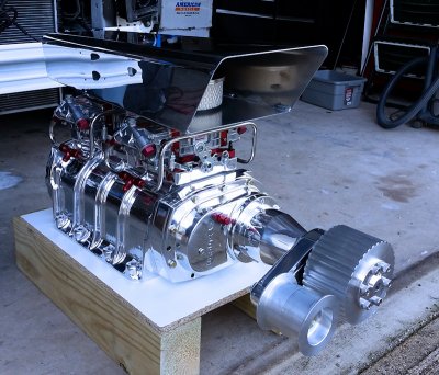

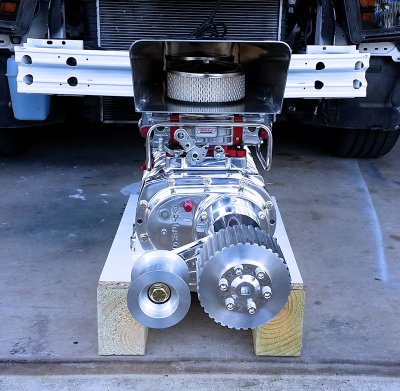

Got the blower yesterday. This morning, I checked for shipping damage, and couldn't resist a casual mockup. I also went ahead and re-installed the harmonic balancer and crank pulleys.

I'm expecting/hoping for 75-80% of what you see there.I'll be able to see to drive, but turning right will be an adventure. I may need to find a co-pilot.

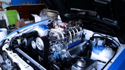

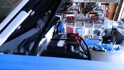

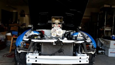

Testing fitment. wanted to make sure the lip on the firewall wasn't going to present a problem.

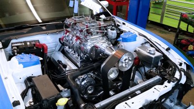

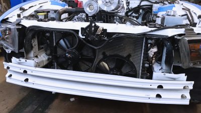

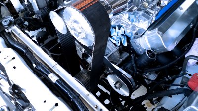

On Wednesday evening, I took it to the shop that's gonna install the blower. As of yesterday, we have the blower installed, the cooling system reconnected, the fuel system reconfigured and connected, the new electric fans mounted, and the linkage setup started. Still need to connect the fans, clean up the electrical (because of changes in sensor placement and removal of A/C), and mount/connect the breather tank to the valve covers.
We hope to fire it up sometime today, and if that happens, there will be videos. (It's gonna whine like an ex-wife looking for more alimony.)
Here are last night's progress pics:

so here's what is probably a dumb question:
With a blower set up like that, I assume it's non-intercooled?
The carbs on top of the blower cool the iats. Gasoline is a great heat absorber. Better than meth injection on a fuel injection setup and it's always going to work because the carbs will always insure gas is being sucked into the blower. No need to wonder if the control unit is going to work correctly like with meth because there isn't one.
I have another questionable question though. Any idea of where this will end up power wise? I'm pretty sure you aren't doing this swap for power but for other reasons but the expected power output is a curiosity.
With only 3 pounds of boost, Dyer's (the people that sold the blower kit) says 20-30% increase. That puts be between 540 and 590 at the wheels. And you're right, I don't really care about the power.
