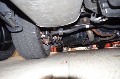

So I just got a 25mm Boss Sway Bar CR3Z 5A772-S and I thought I might look into rear springs and shocks while I am at it. A guy on Ebay is selling Boss takeoffs but the part numbers seem to match any rear Mustang GT springs and shocks from 2012 to 2014. What is interesting is the takeoff number is BR33 18080 BC for the shock. Ford does not sell that shock and they say it should be BR3z18125E for Track Pack. These are sold by RockAuto for about $30 each. Right now it seems the only real change in the Boss rear is the 25mm say bar vis 24mm.

I decided to leave the stock springs and shocks alone. I will just have the 25mm Boss rear Sway Bar installed. I am sure the Base GT stock shocks are within the adjustable range of the Boss Shocks. I inspected the shock bushings and they look new.
