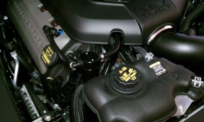

Well, I got mine in and managed to install it in a matter of seconds! Literally.
I've not seen any of the throttle improvements that Frank mentioned (I think it's the placebo effect Frank), but I am certainly collecting oil.
I think what has actually happened was the JLT showed me I had a fucked up PCV valve. The valve probably got shaken around a bit as I was installing the can and worked for a little while. Once it got real cold though, it stopped working and I had oil being blown out around the PCV valve grommet on my newly painted spark plug coil-over covers. I changed it yesterday, well the Ford dealer did, and now I no longer have the very quiet ticking noise I was getting from that side of the motor.
With the new PCV valve in, I'm no longer getting my RPM surge and drop that started happening a few weeks ago. About the same amount of oil is in the can though.

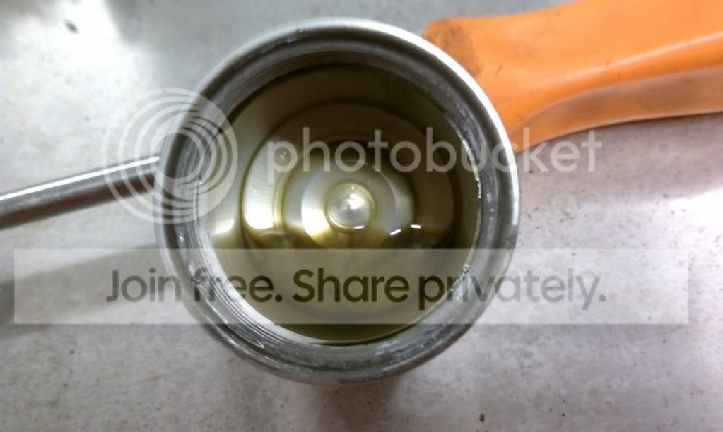

The enclosed picture shows the amount of oil in the JLT separator after 1 week of commuting to/from work and never went above 5K RPM. FWIW, I've practically had oil dripping out of the filter on my 2001 Lightning, but didn't think it would be this bad for a NA motor. Then again, I've replaced intake gaskets on my 2000 540i and 2001 Suburban and both intakes are completely coated with oil on the inside... The shadow is making it look like a ton of oil. There was probably a bit less than a teaspoon in there. Still more than I would like getting sucked back into the intake.
A :thumb2: to JLT for a beautifully machined catch can with a clean OEM fit.

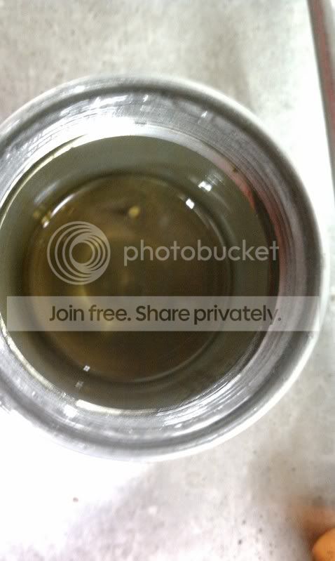

Sorry if asked before. I did not read through all pages of this post, but should I be worried if I see a faint metallic sheen in the oil collected?
My car has 3,600 miles and had it's first oil change with Mobil 1 10 days ago. I assume it's still breaking in and it's just from that. I did put it through several 0-110 runs and a race with an Evo 9 while testing my new Bama race tune and CAI.
I did not see any sheen of metal in the break-in oil, but did not expect to see it in the collected EGR oil

Just scanned through all the pics of other's collected oil and I see the same metal sheen in two other's oil so it must be normal.
For example GeorgeInNePa. He's thinking it is water, but I think it's faint metal from the rings/bearings because a magnet does move the small specs.
The can was emptied after my last pic (In my thread in Pimpin' It {My First Mod}.
This at 264 miles since last empty...
Nice oil and water mix.

I think it's either aerated, or it's the moisture in the oil we are seeing.
Nope. Take a magnet and swirl around and some of the flakes stick to it. The rest must be aluminum. I'm sure there's water in there too, I'm just saying there is metal too and wondered if it's showing up in the 5.0's with higher miles than mine at 3,600.

I'm not seeing it in mine - ~9k miles. Mine is a lot more milky oily than my original pic in this thread.
