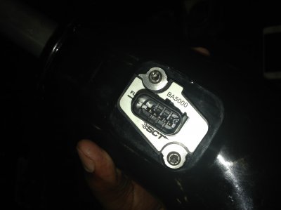

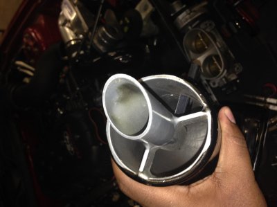

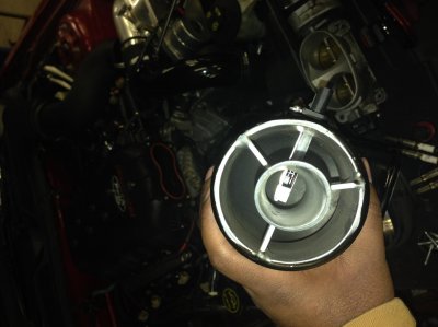

2nd issue is that the procharger tube in pictures below he said he doesn't remember seeing one like this with the way the tubing is made has anyway else seen one like this.. He stated the ones he seen have no internals like this one to direct air flow.

Can't see the pics to well but they will put something like that in the tube to clean up the air flow so the maf gets a better read

That's the older style of maf location. Procharger has since moved it to the intercooler. Your wideband bouncing could be from the maf location. Are the short term fuel trims bouncing too? How is the pcv set up? I had a hell of a time with breathers on my procharger. I finally had to go with a breather on the passenger side and the drivers side connected to the intake with an extra pcv valve.
Has your tuner increased the manifold volume to account for the extra volume in the frpp intake? IIRC it's a little over 12 liters which is about a third more than the stock one.
