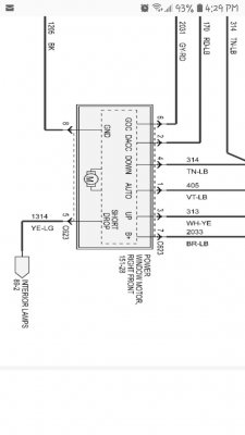

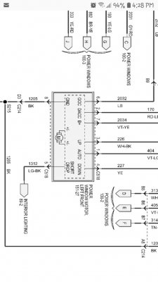

Well I have always just been able to do stuff like that by touching power to a 12v battery. You just need the power and ground to complete the circuit. You're not hooking it up to anything else that could cause worry. The switch runs on the 12v battery. Its just normally wired in with protective fuses and relays for safety of fire and other parts damage. I'm no expert but I have done it with so many things. Same idea as hooking up a little light bulb to a switch and a AA battery. Positive wires, negative wires, switch and battery. I had to do this when selling my factory powered seats. We just ran power and ground from a extra car battery to the seat switch. I touched the wires to the battery posts while he used the switch to confirm the motors were working and the seat moved.
Personally I wouldn't run through the factory wires. Run your own wires straight to the motors in the correct positions for the up function. Hope this helps. The diagrams are from IIHS.Screenshot_20181206-162833_Samsung Internet.jpg Screenshot_20181206-162923_Samsung Internet.jpg
