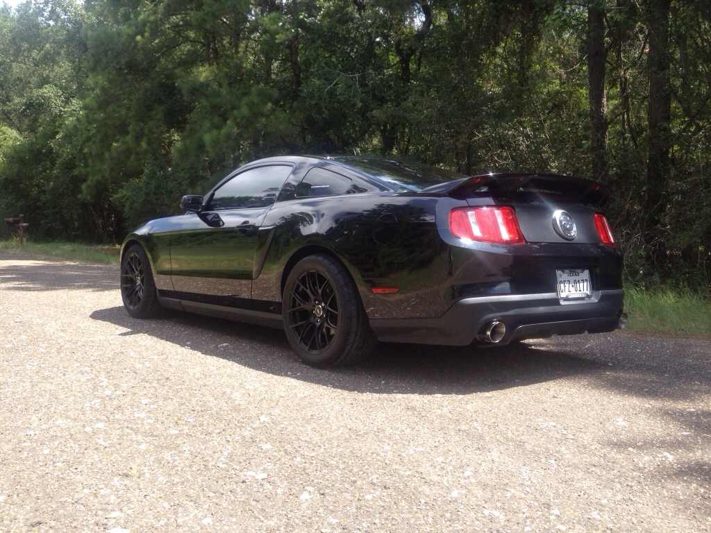

18x11's all around:

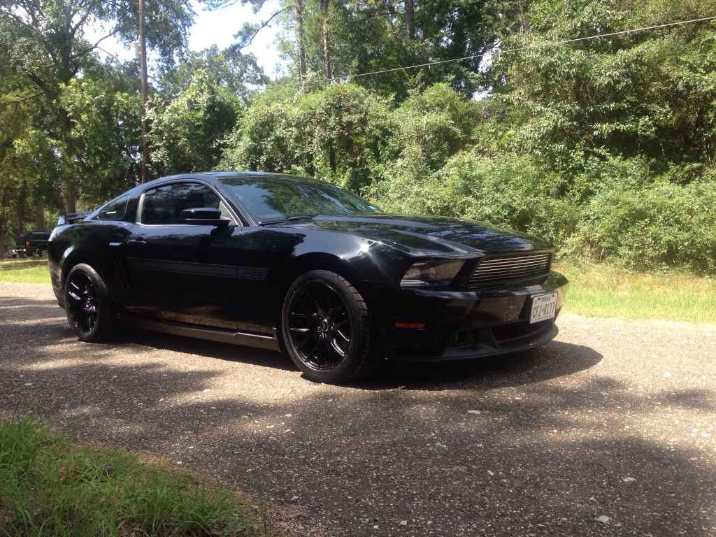

18x10's all around:

Yes absolutely.
I have run 18x10's and am currently running 20x10's all around with plenty of clearance.

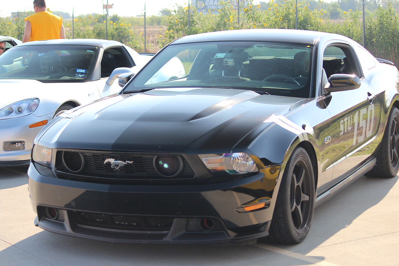

18x10's with 285's all around:
20x10's with 285/35 fronts, 305/35 rears:

Running 18x10's all the way around

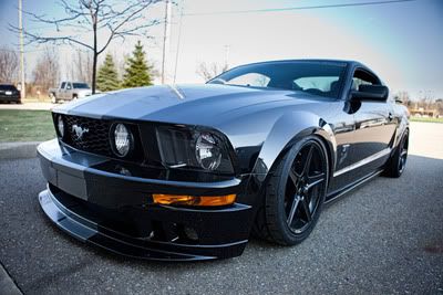

Would love to see more pics of cars running a similar suspension drop on 18's as the one below but using 35 series tires instead. It's such a damn shame that the choices of good tires in 18 x 40 are so few.
Sure. 18x10 SVE Drifts (43mm offset) front and rear with Nitto 285/40-18 555s all the way around. Fits perfectly, no rubbing ever. Car is lowered about 1" front/1.5" rear.

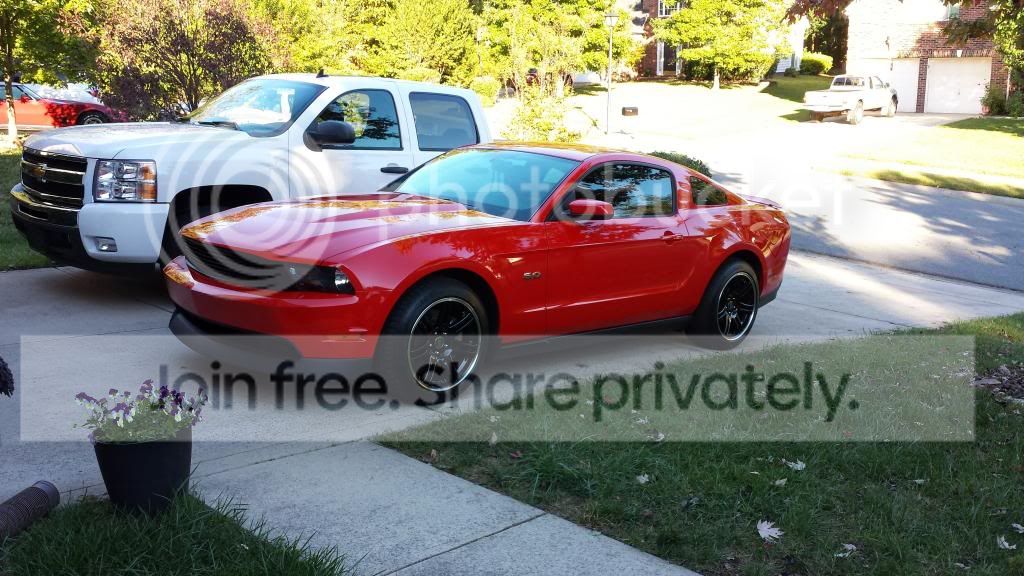

American Muscle 10th anniversary 18x10 (+45) replicas for me. For now running 255's all around. Yeah they're stretched a bit but not too bad really. Already had the tires that are practically new so I'll have to wear them out before getting at least 275's on there.
Yes, I know... it needs to be lowered :yuck:
The one of my car on the 18x10's is when it was lowered ~1.5" all around. 285/35/18 tires
Thanks for the info. I guess I always just assumed you were lowered 2+ inches because of the AST coil overs you were running. I was ready to buy some AST's myself until I was told that they really need to be run at 2" or more of drop to stay out of the internal bumpstops.

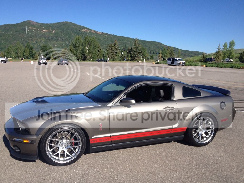

Hmm never heard that....the picture with the forgestars is 2+ inches though
