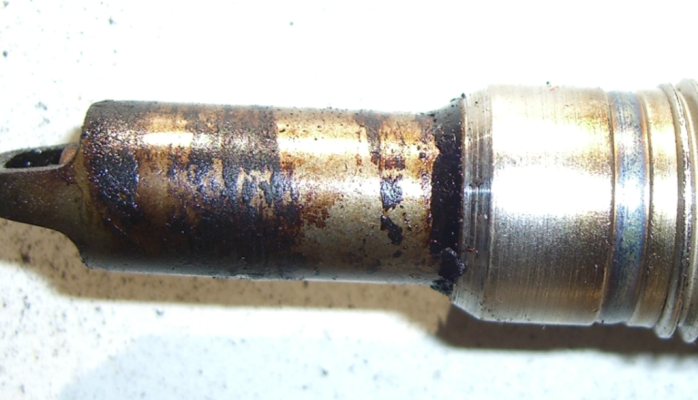

I removed the plugs for the first time since 2007 some weeks ago, don't be afraid. The key is to modify your torque wrench to left-hand usage and do not turn with more force than 25-30 Nm. It took a lot of time but none broke.

I had only bad luck with Champion. Ground straps always broke off.
SP547(x)s have treated me just fine, as have autolite HT1s. Don’t worry about the updated 2 piece plugs.
If you are removing them for the first time, they will likely break so have a lisle tool ready. It’s scary, but it’s really not a big deal. Big enough problem that it’s common and usually an easy fix. I broke 1 when I pulled my 07s at 50k miles, lisle tool worked like a charm. My previous 06 didn’t break any when I pulled those at 40k miles, but YMMV.

My 07 had 185k miles on it when I got it. The plugs were original. My old boss said to let the car run and get the engine completely hot, it softens the carbon. Then quickly zip the plugs out with an air impact, one the moves as quick as possible.
So I did it. And it freakin worked. Didn’t have a single issue getting them out

Hot engine. Small impact. NOT CHAMPION PLUGS.

If you turn the plug out the carbon stuff gets squeezed into the gap to the cylinder head and the necessary torque increases. If you do not stop and wait some minutes that the PB blaster or similar can lubricate again you can break the tip off.
