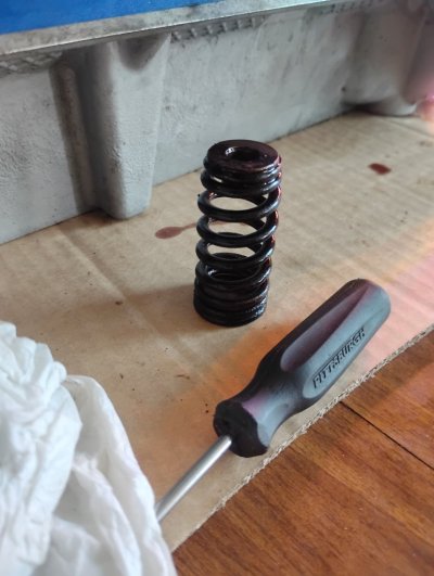

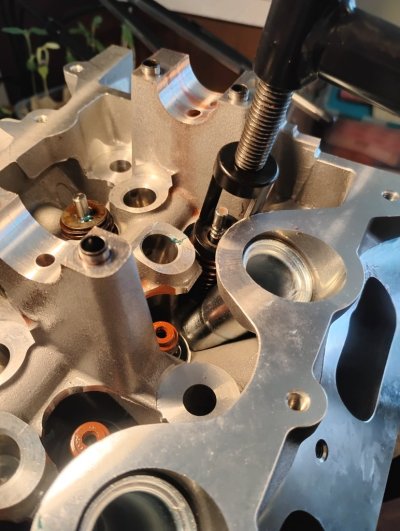

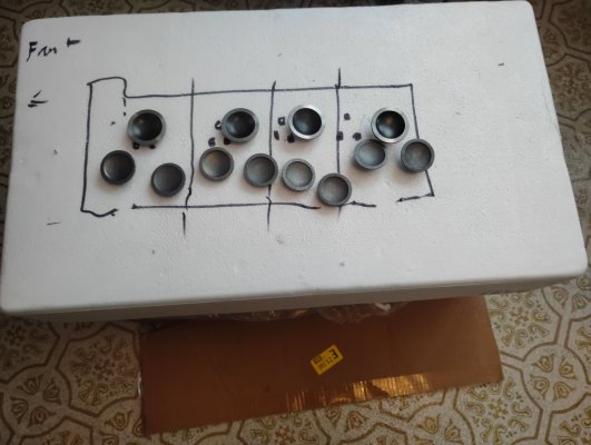

Got the springs and retainers out of the old head. I was smart and brought the head inside and used my daughters craft table to do this as comfortable as possible... And it was still uncomfortable
still a pain..
But none the less a win .
Now for a break

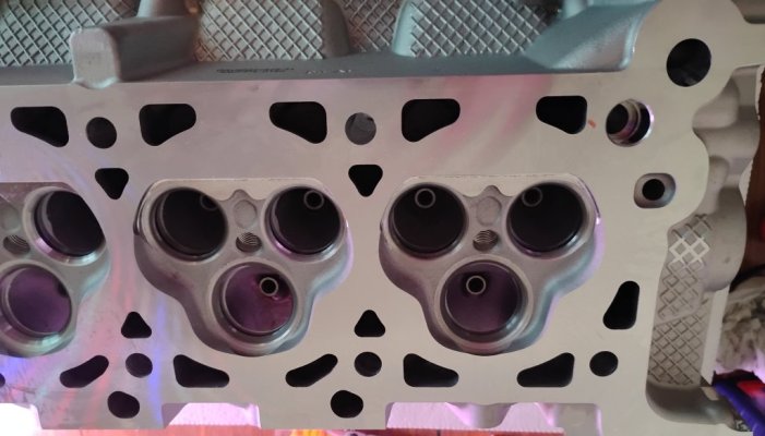

yea the new head dont have a stuck spark plug ,,lol
the head is %100 legit..
and the new head is %100 cleaned ,,no after work metal shavings anywhere..
now if they would make the engine block ,id be golden

A mls head gasket (multi layer steel) flexes and will most definitely seal an uneven block ,,but of course there are limits to how far ..
I just got a new cylinder head off Amazon and it's flatter than my square ,, so it's true ..
Blocks shouldn't leave the factory that's out of square because they would be out of spec and get hit by quality .

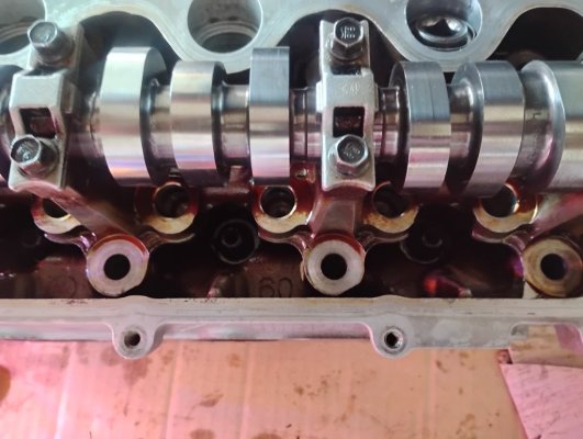

I stoped using the cam tool and opted to remove the cam to install the valve springs and make my life easy and quick
$14 from Amazon
Wish I woulda used it sooner,, but none the less

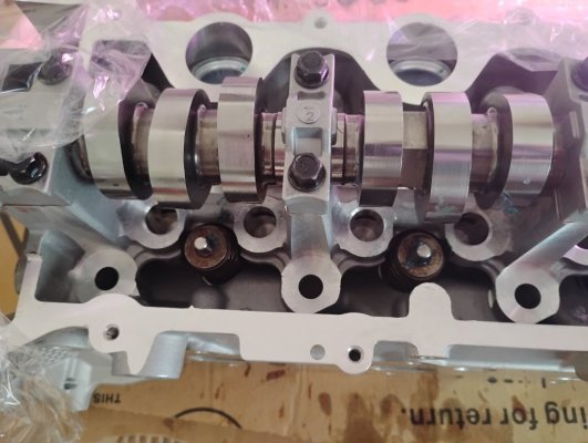

Got all the springs installed and also the two core plugs on the head .
Tomorrow I hope to get the roller followers on and the cam and the header .. then it's on the engine block and button it all up

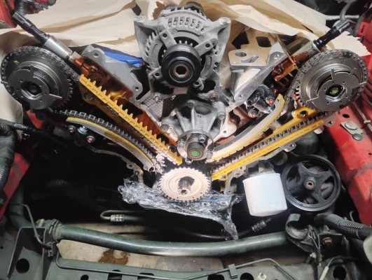

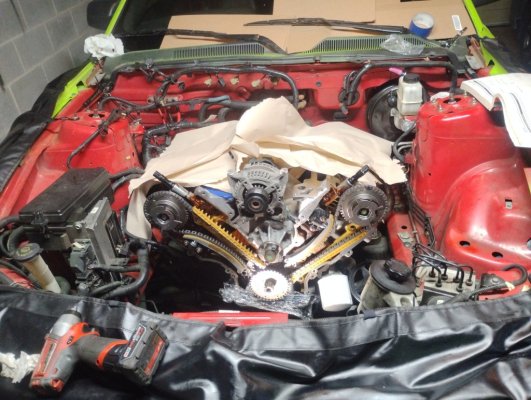

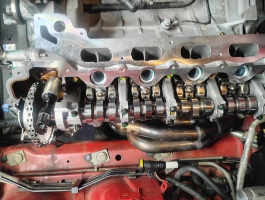

Well after being sick and life in the way. I got around to getting the head on and timing it . Now it's just button her up and send it..
Hopefully by Saturday cuz I'm very unmotivated right now lol

Looking good!
yea thanks,,,
altho it may seem like it didnt take long to time it,, (it didnt)
i did however get it to the point i was ready to pull the pins on the tensioners
until i realized i didnt install the old vvt solenoid and the body to mount it to the end of the head,,
so i had to remove the timing and the vvt phaser to install it ,, then redo it all ..

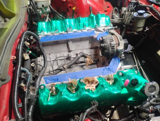

Ok so the heads on and I'm slowly putting everything back together.. got my exhaust hooked back up, the steering shaft back on .
Timing cover back on and new valve covers..
I also got high heat paint to paint the valve covers .
Needless to say it's not. Wat it looked like online .
It's ok tho cuz I wanna see how the paint holds up and then I'll color match it.

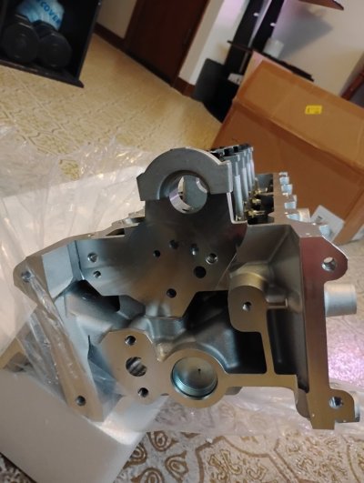

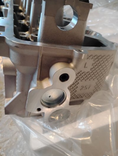

One note about the cylinder head..
It is the exact same head.but...
It's the 09/10 style plugs ..
So my one side is the earlier plugs and my driver side will be the new style
