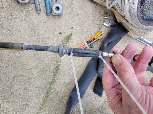

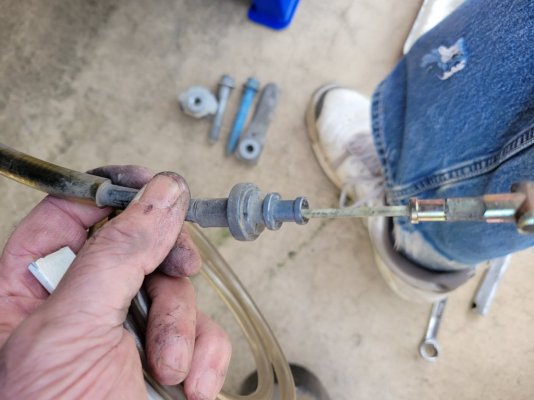

So a little history. When I got my 2005 Roush the parking brake did work however not that great. When doing the suspension rebuild I did see that the rubber boots on both of the parking brake rear cables were Fubar. I used a bicycle inner tube to replace them and thought that would be the end of it. The parking brake over the last 2 years had ceased to work at all. I looked at the connection by the transmission today while installing new pads and the cables were both tight not sagging. The handle in the car seems to be working fine. I am thinking my problem is with the rear cables.

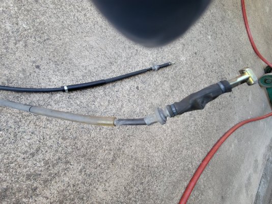

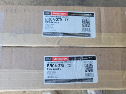

I also read the TSB about the early rear cables being replaced because of that boot letting water in them and freezing or rusting. Since I don't have a freezing issue in Nor Cal I am thinking they have become rusted and seized. I was hoping the new pads would cure the parking brake problem but even pulled tight the wheels will freely rotate.

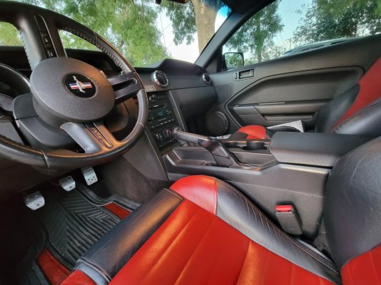

If it's not the inside handle or the calipers that leaves the cables which I guess I would be able to see if they move by having someone pull the handle while I watch the mechanism.
