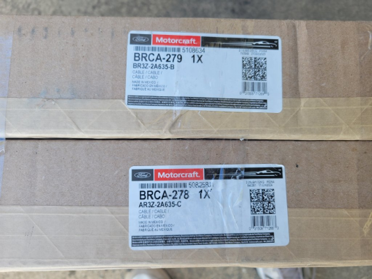

My rear cables were frozen. I replaced them with some oem cables off Amazon. was able to save a length of the inner cable from one of them. If the cable snaps on the front section you could make it work with this if the outer sheath is salvageable. However if you can buy the assembly still that would be the way to go.
