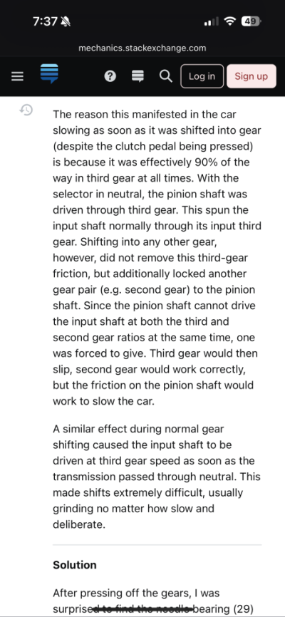

I read somewhere of someone with a manual transmission having an issue that could also be a possibility (attached). When it initially broke down I believe I was in third gear when it happened.
