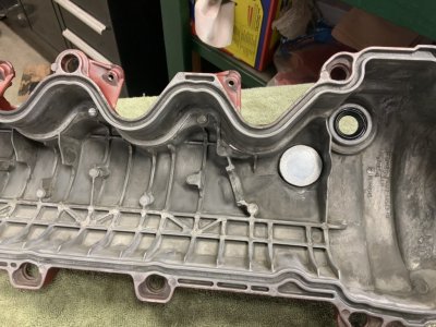

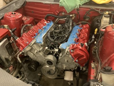

Found these cool fittings in Summit’s catalog to help reconfigure the crankcase venting system. The black fitting is a simple replacement for the filler cap with AN-10 threads in it. The other fitting is meant to fit in a 1 1/16” hole and provide a AN-12 connection. I removed the factory PCV valve from the left cam caver and enlarged the hole to 1 1/16. The body of the new vent was too large in diameter to fit in the space in the cover so I simply ground it about a quarter inch smaller on a bench grinder. After a little cleanup, it fits quite well and seals with an “O”Ring. An AN-10 to 12 adapter brings the filler cap fitting up to -12 size so both sides are the same and ready for whatever hose or tubing I choose.
