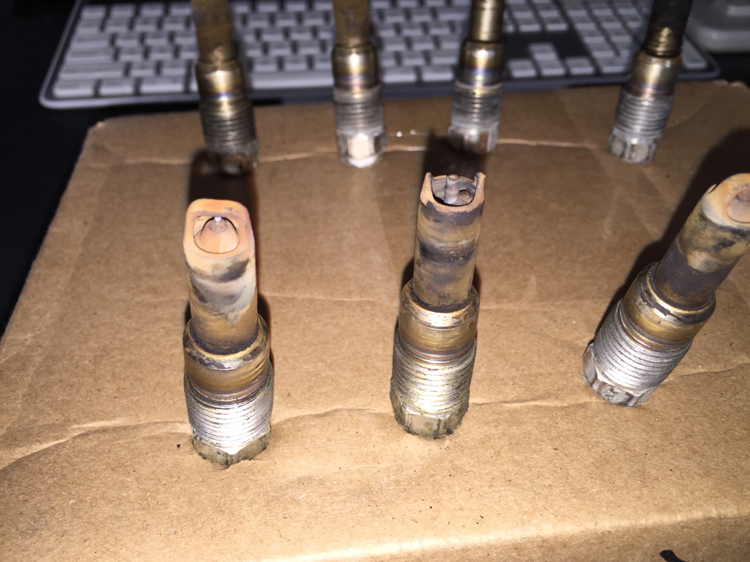

Plugs are the first thing I would have checked.
I ran Torco to eliminate any pre detonation and after still seeing some spark knock I pulled the plugs and found this:
