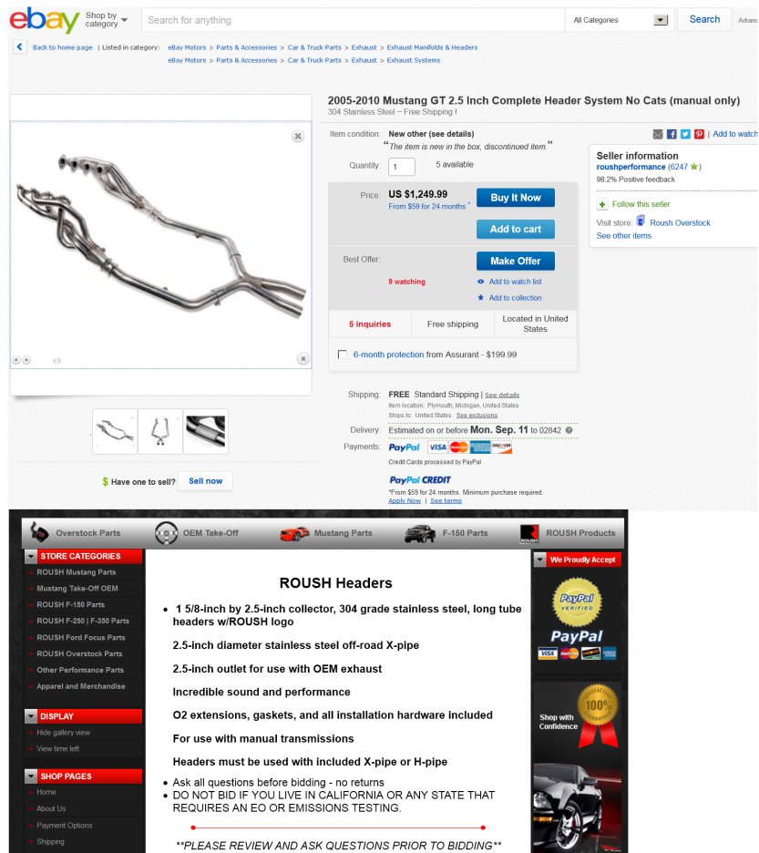

The best quality true LT for these cars are made by ARH IMHO.
That's a good point...the Kooks are technically 3/4 length LT's. I have Kooks with an off road H and stock mufflers and like the sound.
Not sure how much clearance there is with ARH, but I was glad I could get my trans out without taking off the Kooks!

Looking at an interesting Roush/Kooks system on eBay (pic below), it appears to be 3/4 length. Somewhat small, but probably still better than my stock manifolds. I'm not really looking for more power though, so this might be just the ticket. for me. I mainly want the nice tuned sound. I would TIG in my existing hi-flow Pypes cats. What do you guys think about this setup?
Thanks very much for the comments gents!
